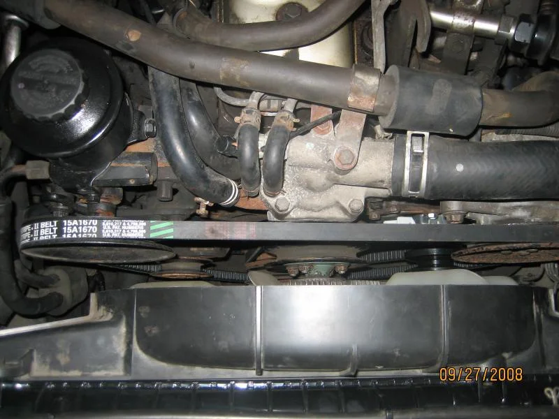

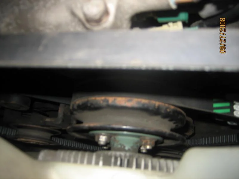

Question 1: I'm using Gates belts. Could that be the problem? I wouldn't think so, but just curious.
Question2: On the fan pulley, do both slots get used?
Does my belt locations look okay?

Correct. Inner pulley of water pump and inner pulley of alternator get driven by the middle pulley of crank. Outer crank pulley drives PS pump, smog pump, and slightly rides in the outer pulley of alternator as a guide.
Gates makes good belts. I doubt that's the problem. I assume you've checked tension on the main alternator belt.
