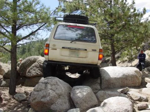

In an attempt to be helpful, I leave the rear swaybar on and wheel with the front disconnected (I pull it at the trailhead). My entire setup feels extremely well balanced, but I also don't have a long travel suspension and my rear swaybar doesn't seem to be unhappy even though I have no drop brackets for it. Here's an idea of front/rear flex with front off and rear on.

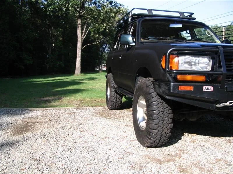

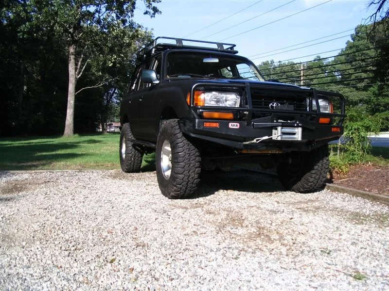

here is a shot of mine as it sits right now. Those are 35 inch truxus tires. medium spring in back, J spring up front. It's perfect with no weight in the back. When i load it up for a long trip, it "feels" and to me sits more or less flat. I don't know if that makes sense, but that's the best way to describe it. Which i don't like.
I think i may go with the j' spring out back. I would like to get different shocks especially up front. I intend to put the hitch pin up front on the control arm (pull the pin), unbolt the shock and let it flex until the j spring starts to come unseated. Add another .5 inch and buy a shock in that length.
But for the most part it is nice and low and wheels great. I may buy a 35.5 inch Q78, but other than that i'll wheel it this way for a long time. I think it's fun using your armor.
