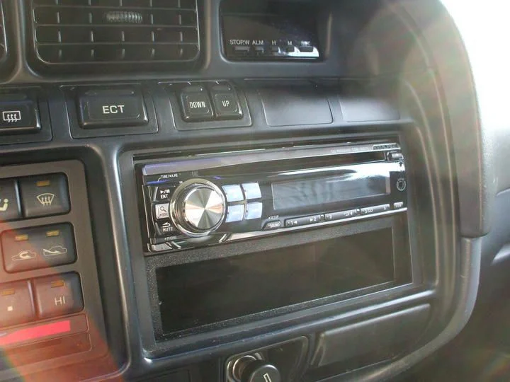

I know it sounds crazy but I believe replacing the radio fixed it. I had it replaced Sat. morning and I've driven all 3 days since and hasnt done it since, although the pressure registers a little lower at idle, possibly the gauge is out of calibration from being maxed out twice. The stereo shop that pulled out the mess circuit city had put in there said it was really cobbled up. Hopefully this is the permanent fix Im looking for, if nothing else I got the stereo upgraded and got rid of a definite short in the dash. The new stereo is a huge improvement over the previous one. Heres a pic.
