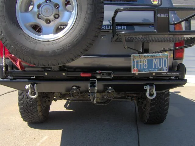

I did same trade study last year Both bumpers plus Hanna would have satisfied my needs in a bumper. Liked Hanna, but he was not taking any orders till Nov. '08. and it would be 3-6 months after that for a bumper. went 4x4 labs for customization and instalation and local for me (see my post on "Which way to swing" for pics). Pounded the crap out of it on the Rubicon while I learned where my rookie rear was. Bumper did great.
I don't think you can lose on any one of the three.
Oh and just a little over 3 weeks from order time to install in late June '08.

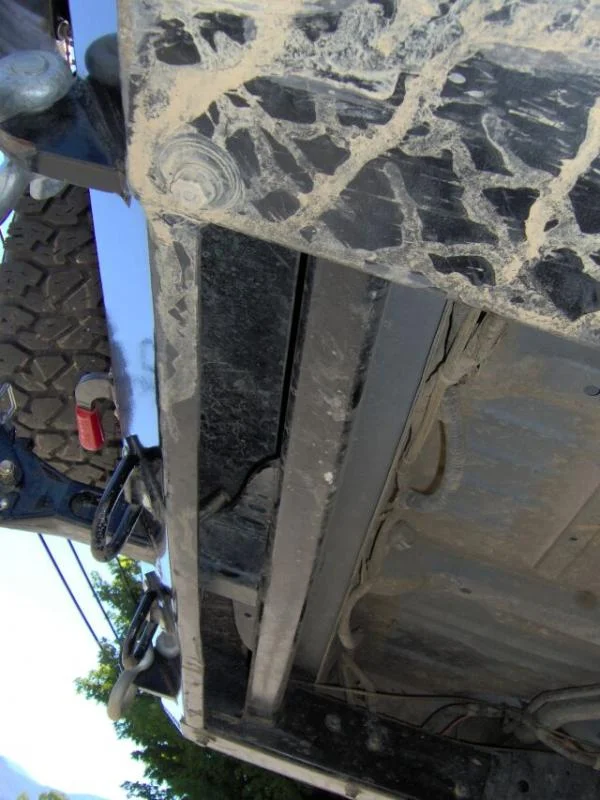

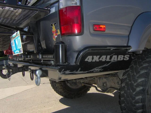

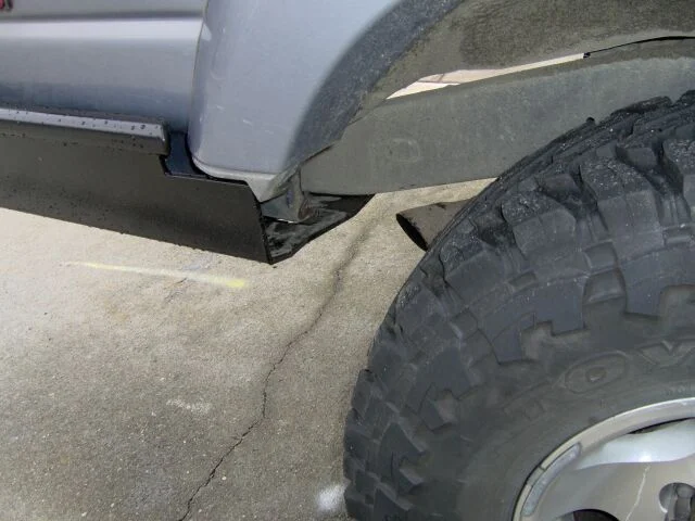

The 4x4 Labs bumper requires that you saw off the last ~5 inches of the frame and once you do that you are commited and the bumper will remain with the vehicle, it can not be reversed or transfered to another vehicle unless the donor vehicle is toast.
Luke offers several possible swingarm combinations and you can pick which side you want the tire on. Christo provides a "standard" configuration that suits most users.
Luke's bumpers come with an integrated receiver tube, Christo offers a receiver tube as an option.
My experience with both bumpers is favorable. On Rubicon I did find that bumper wing impact on Luke's bumper was transmitted into the quarter panels on my wife's truck and both quarters were damaged by bumper wing impacts by the end of the trail. My truck was not on the same trip (thank God because it was a screamig bitch) so I can not compare quarter panel damage apples-to-apples.
Luke's bumper does offer a better departure angle due to the fact that the back of the frame gets chopped off.

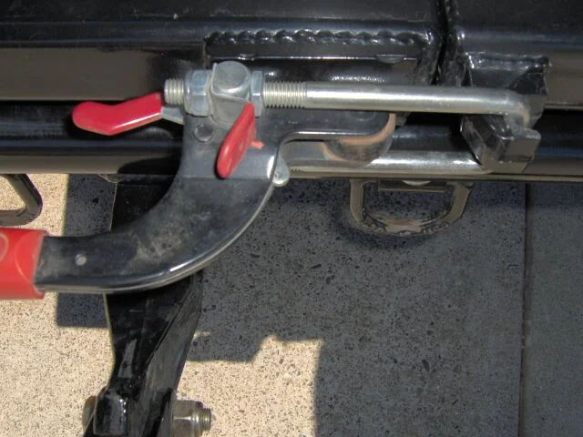

does the 4x4labs bumper have the brace that bolts to the frame from the wings? How about the latch mech.? I like the slee latch design, what with the nylon pad and extra locks on it to prevent accidental release and rattling.
The entire wing is one continuous sheet of steel which wraps around the frame. Better than a bolt up brace IMOP.
The latch ties each swing arm to the other, not to the bumper at all. Mine has never rattled or come open without me to open it. No nylon pad.

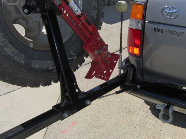

I have a Slee rear bumper with tyre carrier. Mine is an early model. Christo has made relatively minor changes to the design over the years. The bumper is high quality and very sturdy. The bits and pieces that are used are top quality; hardware, bearing, latches, bolts, etc. Everything fit very well and I installed the bumper by myself. No frame cutting, no grinding, no welding... just bolt on and go.
I have seen Luke's bumper on several friend's trucks and briefly watched as Luke and Semlin installed his at CM06. The 4x4 Labs bumper tucks in nicely and the improved departure angle would be important in the terrain that I usually wheel. However, the Slee bumper is strong enough that you can drag if off a ledge without worry.
I'm also a bit on the compulsive side and waiting is not a strong point. I called Christo and his was headed to my house immediately.
