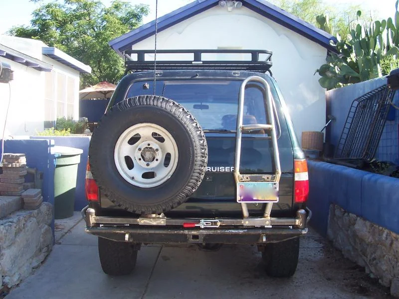

Old 09-29-08, 10:16 PM   #43
IH8MUD Junior
a.mus.ed's Avatar
Join Date: May 2008
Location: Tucson, AZ
Posts: 186
Quote:
Originally Posted by bpassmore View Post
So,
you can get the spare tire, ladder AND can holder on the same bumper? I thought it was an either/or on the last 2 of 3 options.
Gots any pics?
yup. the jerry can holder is a bolt-on attachment to the ladder, so you can remove it when not in use. you can specify what size you want too, 2 or 3 can holder. my 3 can holder holds my ice chest perfectly.
