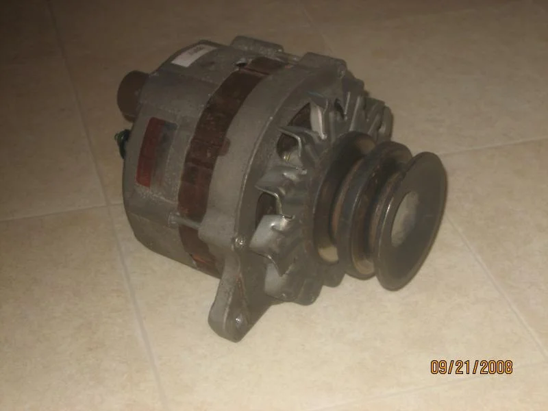

Sorry for the dumb question. But what does an external fan look like? Is it that extra unit on top of the alternator? It looks almost like an extra alternator on top of the alternator.
I'll post pics later of my alternator and see what you guys think.

So,
this is an 80 amp?

Affirmative.

Sounds good. I'll be making a trip to the dealership tomorrow to order one of these bad boys..
