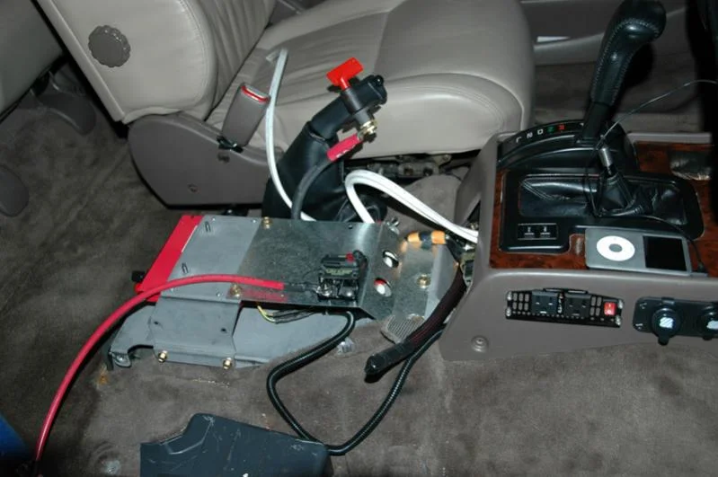

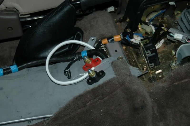

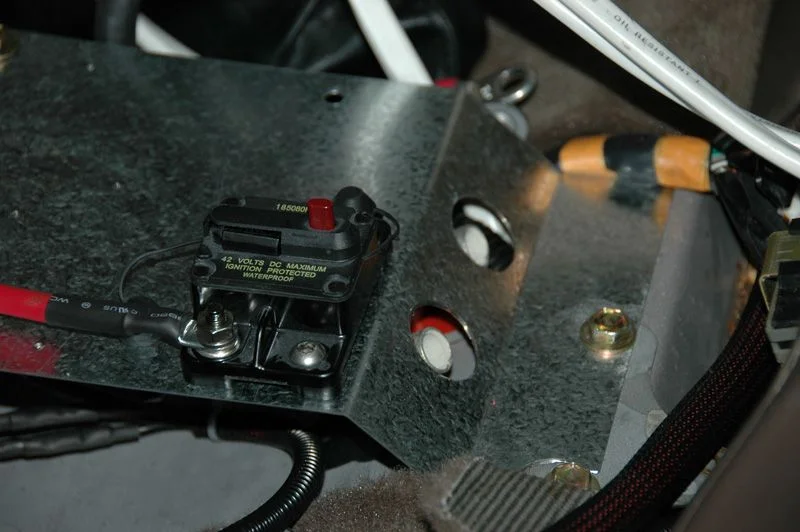

because if you are running an inverter it needs to have the negative run directly to the neg. on the battery, not just a body ground. I wound up running my whole aux. system this way.
Some teaser shots to my next FAQ:

fyi, 1/0 cable is not recommend on power inverters due to the high resistance. 2 guage is highest recommended and at only 6ft lengths. Otherwise use 4 guage on longer lengths but keep the amp drawn under the inverters max output.

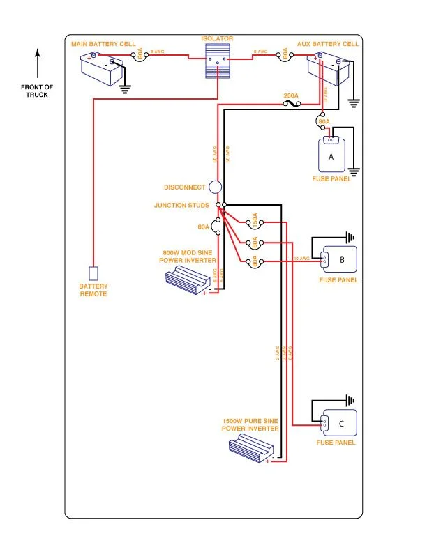

My current set up. I followed the wiring guidelines AND the inverter manufacturer's suggested wiring/fusing.
http://www.btc-bci.com/~billben/maxwire.pdf

BTW, amp wire or welding wire are the best choices due to their high strand count which helps lower resistance and stay flexable. I've noticed a double wire setup like this on high power inverters.
