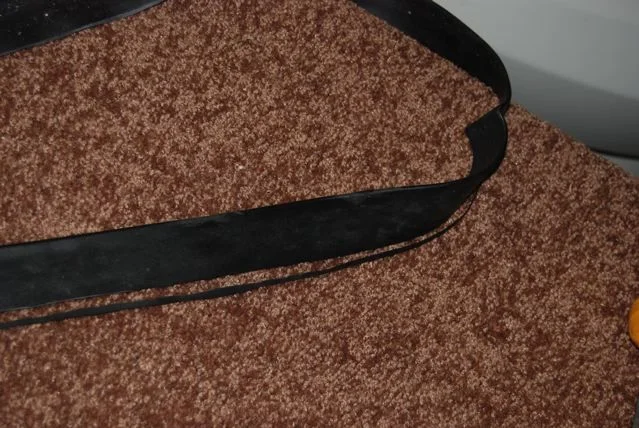

Well I have been chasing some wind noise at the top of the A-pillar on both sides of my cruiser for a long time. I have checked door alignment, mirror sealing, weatherstripping etc. to get rid of the wind noise and never got it as quiet as I new it should be.
I always noticed when I had the sunroof cover pushed back but the sunroof closed there was more noise than with the cover pulled forward. So yesterday I went on the hunt to re-align the sunroof for better sealing and to hopefully cure some of the noise I have been chasing. After removing the sunroof glass and looking at the weatherstrip I determined that over time the weatherstrip has been crushed just enough to not seal tightly at the opening on the roof. This gap either lets wind in or causes enough vacuum to make it sound like the upper door is where the wind noise is coming from.
On to the bicycle tire fix: I knew I needed something to thicken the weatherstrip a very small amount, but still retain a certain amount of pliability. Hence the bicycle tube. You will see in the photos below that all I did was cut a 26" tube all the way around about 3/16" wide. This allowed it to be stretched around the sunroof between the glass and existing weatherstripping making the effective weatherstrip about 1/16 thicker all the way around. Also, leaving the cut tube in one piece allows it to stretch around the glass and then it holds itself in place. All this work was done with the glass off and from the underside of the glass. You can roll the weatherstrip away from the glass easily on the underside and that is where the cut tube goes in.
Once the glass was back in and aligned you could visually see from the top that it sealed better and the motion opening and closing was more snug. My wind noise at the doors and sunroof is gone.
Sorry for the lack of photos with the glass out, I wasn't sure this fix would really work so I slacked off on the photos. So here are a few of the tube cut to size, weatherstrip from inside and a picture of the tube in between the sunroof glass and the existing weatherstrip.

I need more info! this is moving up on my priority list steadily as I baseline everything else, good idea
any more pics would help, it sounds like you put the tube rubber around the glass, with the factory seal holding it in place; did you use any adhesive?

No adhesive was necessyary, the pressure from the stretched tube along with the pressure from the existing weatherstrip holds it in place very tight.

Am I correct in stating that the bicycle tube gets stretched around the sunroof glass, then the weather strip is reinstalled over top?
-KK

Yes, the tube get stretched around the glass, but the weatherstrip is actually attached to the glass so you cannot remove it. You are able insert the tube between the glass and weatherstrip by slightly pulling the weatherstrip away from the glass on the underside.

This looks like a great idea! I have had this problem as well, and as soon as I finish fixing my front DS wheel bearings, I will look into doing this.
And I assume that you left the tire valve on so that you could adjust it to a larger size as needed, right?

did this last night, what a difference a bit of rubber makes with the noise; used to be louder closed than in the tilted up position, now it's opposite and I don't have to turn up the radio when at speed.
hardest part was popping the tube out of my old three speed, second hardest was popping the sunroof garnish pieces off the sides of the glass to expose the nuts.
, job, go do this today if you have noise up there.

The weatherstripping is a good idea. I will do something similar and lose the cardboard.

The mod is done and definately improved the "rattling" noise I had. A heavy duty washboard bump will still rattle it somwhat but a huge improvement over the previous condition.
Highly recommend it.
