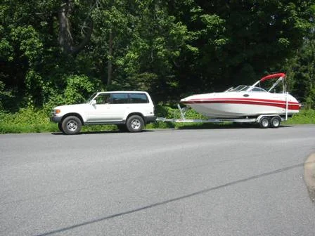

This is around 7k lbs. Trailering not as fun as you would imagine even with brakes on the trailer. Had o/d off the whole time.

Nice Nautic Star Pat- I have the 230 I/O with the 5.0 Magnum. We went with the wake board tower as well..Nice boats... As far as pulling it with my cruiser, no way! We use a H2 and it still has to dig in to lug that heavy boat around.
Aaaaaa, another Nautic Star owner!!!!
Bought that last year. Absolutely love the boat, all fiberglass and a 250 4 stroke... Have you found a forum with other owners yet?
You really need the right trailer for towing anything that size. The 80 just about does it at 55 mph o/d off, and you still talk in a higher voice till you get to your destination.
