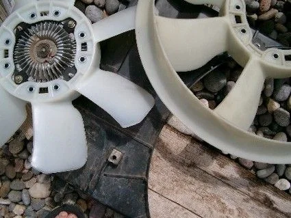

Here is the conversation Turbo talked about
Quote:
Originally Posted by Bruneti View Post
I agree that the "Dead spot" in the stock temp gauge could be a pitfall of your observations. I have no experience with the S/C or the ringed fan blade, but I believe C-dan has recommended a fan blade from another toyota truck application that is not ringed and does not require trimming/balancing. I'd have to search to find the application.
Quote:
Originally Posted by cruiserdan View Post
16361-65020. 94-95 3.0 V6 truck, 4Runner, T100.
Quote:
Originally Posted by LandCruiserPhil View Post
Dan can you post a picture of your magic fan?
This is the only one I have at the moment:
__________________

Why does Dan recommend the blade on the left vs the the one that comes with the SC kit on the right?
What was the other mod George mentioned to the shroud?

Robbie told me a trick. Cut the shroud near the top nice and clean in the middle and then you can easily get the fan out. Make a little metal bracket to reconnect the parts of the shroud and then you can easily take the fan out when you need to.

The ring fan is the original 3.slo fan, it had a few issues, most notably the tendency to come apart violently. It was replaced by the nonring that Dan is running. With the drama that the exploding ring fans caused on the 3.slo's I'm surprised TRD put them in the super kits!

No worries man I was just trying to save you some grief. I'm amazed my memory worked that well and that fast! I think that if you switch to this fan and the thicker fan clutch fluid you are really going to get some reduced temps and with less worries about the TRD supplied fan grenading on you or digging deep into the radiator rows both of which have happened to several fine folks here.
