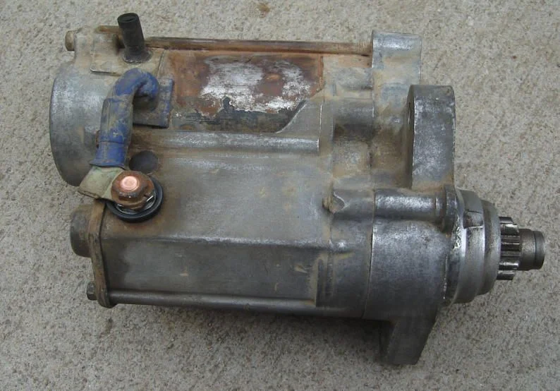

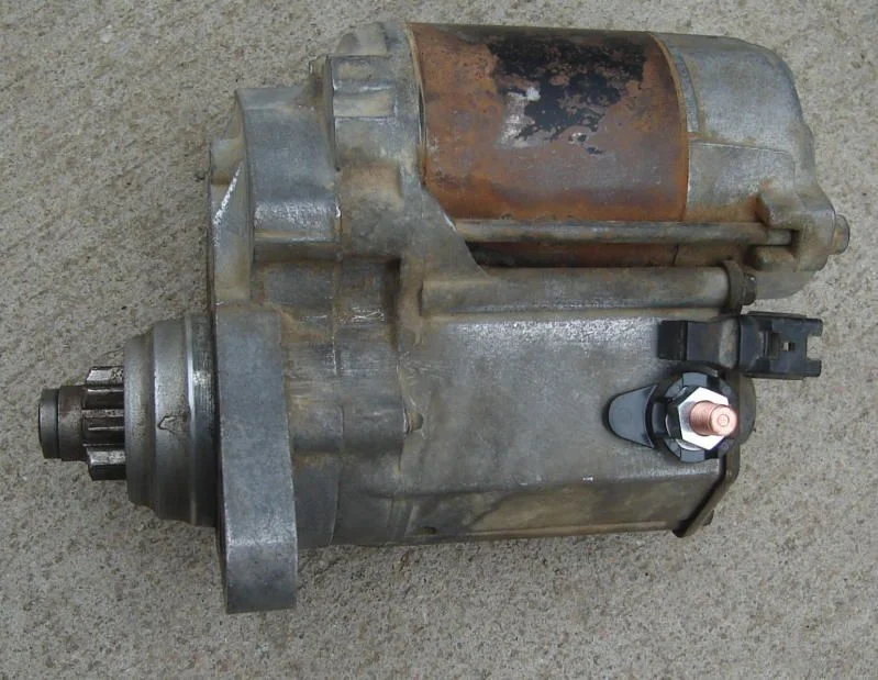

are there any stampings to id an oem starter? i've got one that was rusted like crazy and if there was a sticker, it's long gone.
odd thing was when we tore it apart to do the starter contacts, both contacts were the same. is this maybe a warm weather starter? or aftermarket (my guess). it's on a 95.
also, are the solenoids interchangeable between the different model 80 starters?
