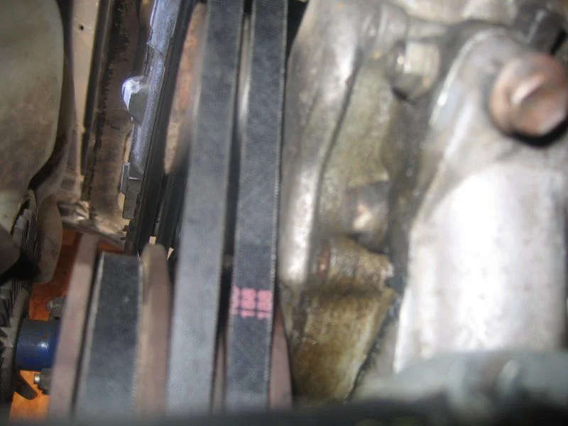

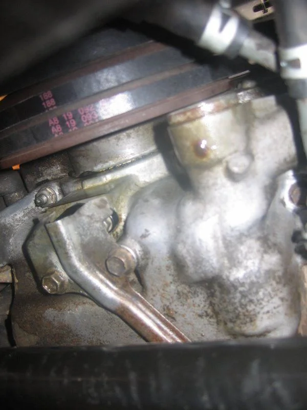

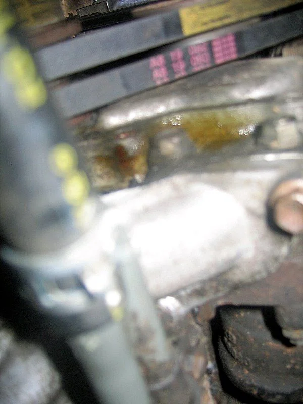

Heh, finally figured out this stupid leak
When I did my oil pan arc seal last year, it sure didn't look like it was leaking from there.
Well, I guess time to call Dan and order
  1. Oil Pump seal
  2. Crank Shaft Pulley Seal
  3. Idler Pulley
Those of you that removed/replaced your crank shaft pulley, what did ya'll use to tighten that Crank Shaft Pulley? I am looking for the best technique + tool.
Thanks
