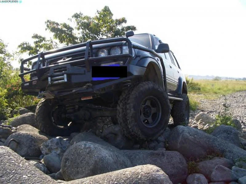

Not sure but believe are the same .. actually here we have the 4 square light setup, and it's outer H4 and inner H3 ... anycase I was tired of this situatuion coz u are using the half of the ilumination potential of the hole setup .. so I made my new wiring getting the signal from the factory one, that let me controll the hole system exactly as I do before ..
I end using 3 rellays per side ( maybe someone with more experience - knowledge in electrical stuff can do better ) and 4 H4 100/90 Bosh bulbs ..
Right now I'm with one hella and one bosh headlamp .. just to figure which it's the better option .. let me take some pics tonight and I will post it back here

You can see what I'm talking about by looking at the last pic that Tapage has posted above. Those square lights can be purchased by your local Checker, Autozone, Pep Boys, etc... (Although I would only get Cibie, Hella, etc...)
It's the bezel that holds them that are vehicle (80) specific. The one(s) used in the 62 "might" be close enough in dimensions, but most likely the mounting points and such would be different. You might be able to weld them on or whatever though.
Japan did not get those lights, so we would not see them in wrecking yards, although few people have them.
And finally, the corner marker lights are slightly different in shape, so you would need to get the ones specifically designed for the quad lights.

Yeah, I like the 62 style light set up as well.
Hey solidfrontaxle, check this out .

Yes please.
