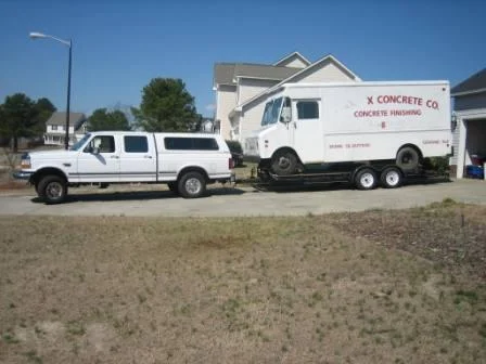

I have done a pretty good search and found a lot of good reading.
Is there a way to BEEF up the stock tow hitch. I know of air bags and sway bar devices which are AMAZING. But to me it sounds like the engine is the limiting factor in the towing rating?
Is that the case or is it the combination of brakes, frame structure, wieght of pulling vehicle, and the hitch itself.
Looking at replacing my F-250 with a diesel powered 80. I use my truck a lot but if I could replace it with this 80 I think I would be happy with the dual purpose rig.
What are your thoughts?
PS for those asking I don't have anything specific but I have towed some heavy stuff before.

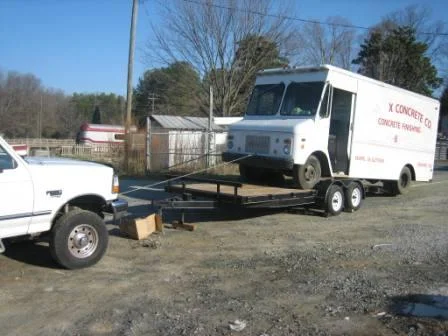

I hauled this 180 miles and my truck pulled it at 60 but with a little work and thank god for trailer brakes..they were maxed out on my truck and the trailer. But I usually pull something a lot smaller.

The towing capacity of the 80 is 5,000 lbs, dead-weight only, no load leveling.
I would not attempt to exceed that, it will be difficult to get it rolling and even harder to stop.
