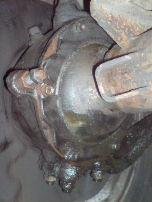

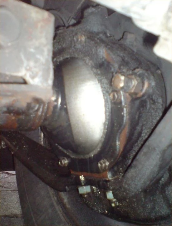

OK, here's the '93 hubs :(

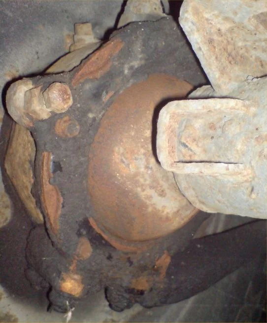

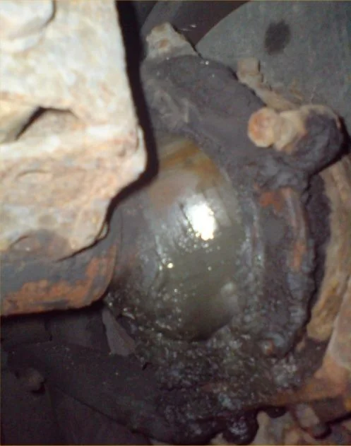

And here's the 95 (looking a bit unloved at the moment - she'll be shipped within a few weeks)

Judging from those pics.
You say you cleaned the 93 up but the it looked like it was leaking motor oil......Id say both inner seals (the ones that keep the diff oil in the axle housing) are gone and the lack of "birf soup" means your knuckles do not have enough grease in them to make soup, OR you are past the soup stage and the oil has flushed the grease out 30-40k ago.
The 96 passenger side (the dry rusty one) scares me, with only 130k miles on her I would almost say it has never seen that grease plug removed. Take the plug off/out and insert a chopstick or the like and see what you find, that knuckle is supposed to be 3/4 full of grease, a healthy knuckel should have a smear of grease on it and only slightly dry on top.
The driver side on the 96 looks like typical seal failure with birf soup but has been like that for awhile.
In my opinion grease leaking untill you can get the service done is better than dry anyday, grease the knuckles (through the plug hole) and top up the diffs untill you can get the work done, the seals are gone anyhow so there isn't to much for you to wreck by lubing them, hopefully they are not excessivly worn from lack of PM.
Good luck

the plug is in every one of your pics, it is forward of the ABS sensor (doo dad with the wires coming out the top) and closer to the backing plate.
12mm square bung with visable threads into the knuckle.

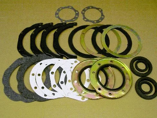

Can anyone please tell me exaclty what seals / bits are in Dan's kit ?
I need to order the individual bits (I'm in the UK), and don't want to forget something and have no car
Uk supplier (Milner's) I've found does this little lot as a kit:
All non-OEM - should I go OEM instead ?

Here are my notes:
LX450 - gasket kit content for rebuilt front
*You can piece what's in the 04434-60051 kit and it's actually cheaper. You may or may not need different shims to setup the trunion pre-load. I did not last time.
The 04434-60051 consists of 2 of each of the following numbers:
90313-93003 $27.22 ea
43436-60011 $1.14 *ea
43435-60020 $1.03 ea
43204-60031 $27.35 ea
43422-60060 $1.51 ea
*Total $116.50 versus $201.03 for the kit, same stuff.

Got under both cars this evening, got those plugs off the top, and poked down inside....
The 93
Leakiest balljoint full of clear/yellow (lithium?) type grease ? Added a bit of moly grease. Also the lower studs/nuts are new, so I guess this was serviced at some point in time, and a slighlty unusual choise of grease employed. The plug was also insanely tight on this side, I actually splayed my 12mm spanner
Not so leaky balljoint seemed quite full of grey (moly) type grease, added a little more anyways.
The 95
The leaky one was quite full of moly grease - added a bit.
The dry one was quite dry - just traces of moly inside. I tipped in a teaspoon of diff oil to try to address the rusting at the bottom. Then added a few fingerloads of moly.
The diff was also a little down, needed about 3/4 litre (I know topping this up was "a waste", but this one is going to get rebuilt when it gets to Zambia - I have a good mechanic there - so only needs to manage a 75mile drive from the border to my house)
Also did the transfer case on the 93 - easy enough, the old oil looked a little thin, but no swarf/crap. Suprised how little it takes.
Thanks again for all the help and info - JB

Ordered a hub socket
Ordered the non-OEM kit (pic above)
About to order OEM as well using the part numbers supplied -
I have two cars to do, so I can compare/contrast the bits and see how they hold up!
The non-oem kit was £30, the OEM works out at £130
- I think I'll put the cheaper one on the UK car, Zambia is tough on cars.
Also got a couple of bearings at £40 a pop, bit worried about the dry one, either way, two bearings when I'm currently running 12, they're going to get used sometime
Cheers- JB
