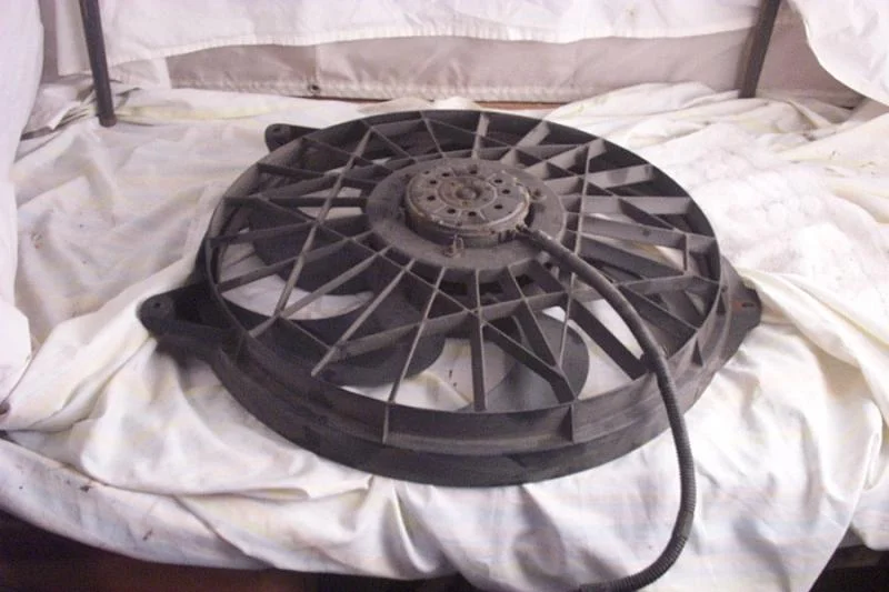

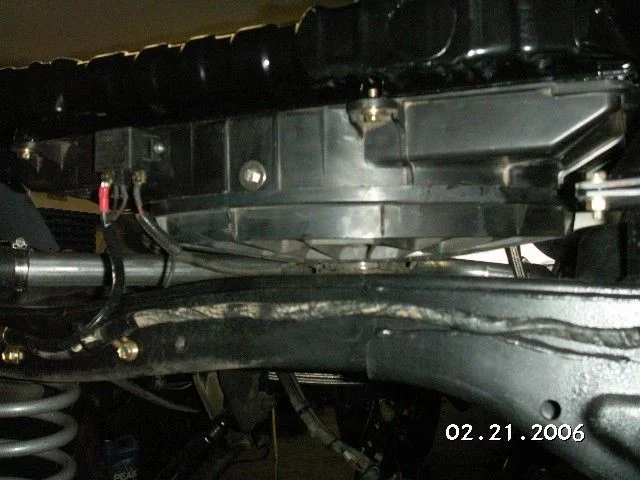

I mounted a MK8 electric fan in my 80 series shroud and it cools the truck as good as the mechanical. The Ford fan is about 1" smaller diameter than the LC and needs some minor tab trimming. I used 4 bolts with 1/2" spacers and mounted the fan flush with the 80 shroud. I would also buy a Delta DC Controller to control the fan. It will handle the amperage and change the fan speed according to the water temp. Yes temp sensor is included. Pics included.
G
G
Gary, thank you. One issue I'm having is that I don't have a shroud anymore. I will look into getting a new one and trying this setup out. Thanks.
They say you get a hp gain (8-15hp) ditching the mechanical fan. Feel a difference?

I didn't drive the truck with a mechanical fan so I don't know. I do know that the loss of the mechanical fan will free up HP, but the extra load on the alternator because of the high current fan will probably negate any seat of the pants feeling. The nice part about the Delta control box is that it only runs the fan at the needed speed to keep the engine at temp. One thing I would do on the controller is match the fan operating temp to just below the thermostat temp instead of the 180 degree setting. Its a matter of changing jumpers on the controller.
