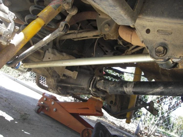

Seems like everytime I go out I candy-cane my driveline.
This is the third time now I have to get it re-done and it is getting old at $100 a pop.
Can I purchase special 'Candy-Cane Resistant Tubing'?
Has anyone built a driveline guard? I saw one on a jeep I wheeled with a few weeks ago and it looked pretty slick.
Any ideeers? And don't tell me to stay off the rocks...

Is it bent or just scratched up?

If it is 120 wall tubing, then just leave it. I have done much worse and never twisted up the tube section.

wERD, mine looks 10 times worse with no issues,

That actually WILL buff right out.

Hard to tell in the pic but the shaft does have a pretty good dent in it.
Bent? Not sure but I do get a hum on the highway.
I am more concerned with the vibration hurting my TC.

Your tc will be fine. It has a big mf bearing in the back.
How much do you drive this truck on the road?
btw, I don't think a hum is going to cause any damage at all. If it pisses you off enough, fix it.
As far as driveline protection goes... You could build a skid for it, but that would further decrease clearance, add weight, and possibly bend into the shaft if not built properly. If this is a common problem for you, I would get a shaft built with serious tube wall thickness. Maybe out of chromoly steel.

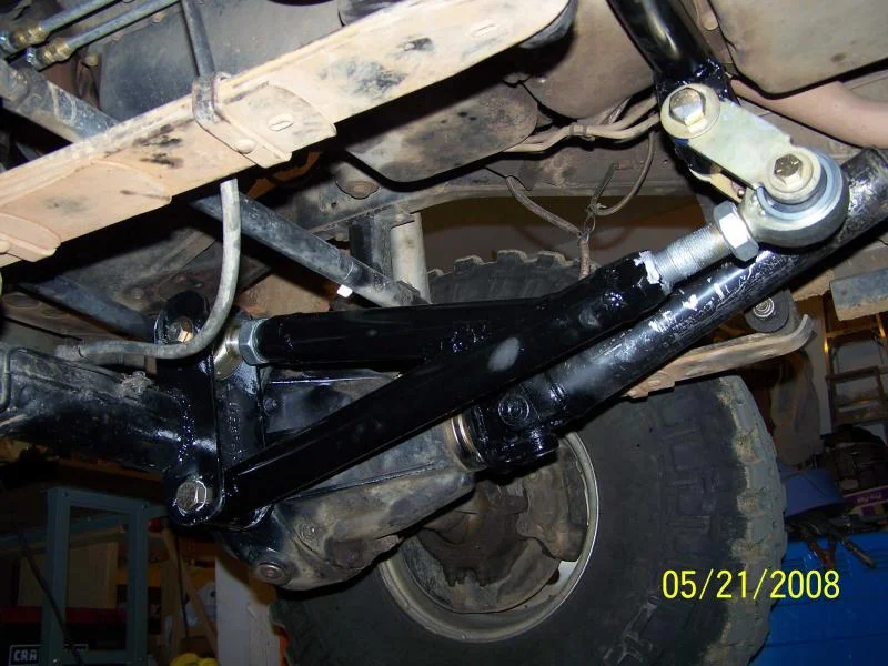

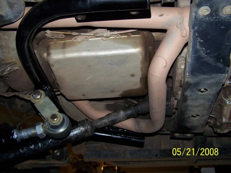

I built this as a traction bar but it has saved my front drive shaft a couple of times already. I am thinking of building one to protect the rear drive shaft. It's made of 1.5" DOM 1/4" thick steel so it can and does handle rocks. It sits just below the height of the drive shaft by design so that it protects the drive shaft.
I will be starting on the front diff protection tonight. I am going to bend some 3/4" pipe into four half loops that will be welded vertically to the top and bottom of the axle to protect the front diff cover and drain plug on the bottom. Should be easy and cheep to build and install.

Why did yo uneed a traction bar on the front? Is that on a 60?

Got all your wheel weights on? I have a humm too and its tires, I have a pretty good crease in my driveline with no issues and have it stripped like a candy cane all the way down.

I have some small dents and a christmas stocking full of candy canes. I'd leave it alone until it gets bad. Mine is still smooth after one rebalance several months ago.
I bought a second rear shaft that I keep as a spare. It had been balanced and checked out by Six States when I bought it for $95. At some point, if I am messing up the rear enough, I'll just swap out the beater shaft for the tough trails.
It's either that or more lift and 37's/38's/39's...

I'm noticing a little leaf spring, not to mention that if the 80 had a rear driveshaft angle that steep it would need 12" of lift

That's a front DS in the pics.

Not to mention that the engine is bass ackwards.

You can put a hose clamp on your drive shaft over the dent for a field fix. Put it on snug, but not tight. You should be able to move it on the shaft with your hand. After you drive it for awhile the hose clamp will move and balance itself. The vibration should be gone. Once it does that just tighten it down.

Pretty tricky. Have you ever tried this?

Did it on a buddies Jeep three years ago when going through Swamp Lake. He is still running the hose clamp as of the last Tech Inspection.
