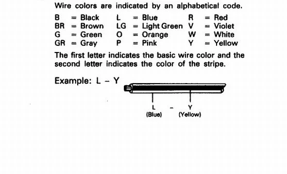

I have a B&W schematic from the dealer on speaker wires...can someone fill me in on what colors correspond to:
L
LG
V
P
Y
B
W
R
Thank you!

For future searchers.
-B-

Thank you both. Superb.
