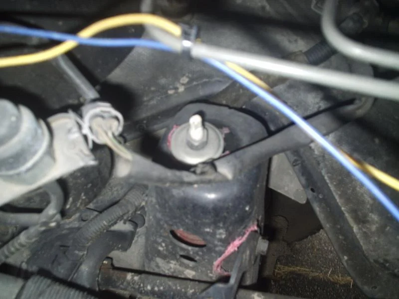

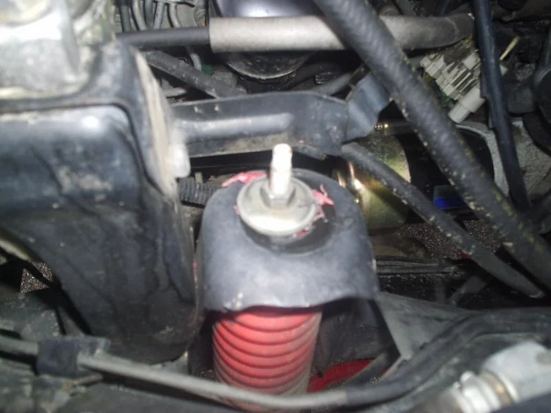

I'm new to all this coils n stuff, and after this weekends maiden voyage it was noticed that my front shock top side bushings blew up. They are both loose enough that I can grab the little thread protusion and wiggle things back and forth.
The truck (1990 hdj81) has a rancho lift (about 3" perhaps) with rancho 9000 shocks. What bushings/part number do I need to order?
And any thoughts on why this happened? Shocks too long?

In my experience this happens with bushings that are dry rotted and brittle. You may want to check the condition of the shocks before you get new bushings, which by the way are available at most auto parts stores as generic replacements.

hey there, i just replaced mine a couple of months ago. are both sides (top and bottom) of the shock loops, or is the top bushing going thru the bolt that i can see on the pic. if the are both the same, i got mine from lordco, energy suspension #306-9-8107G. they are 5/8 hourglass. hope this helps.

If you don't want the after-market urethane bushings you can use the OEM rubber bushings. They are softer. Be sure you torque the nut on top until the bushing starts to bulge. Do not over-tighten or they will bust apart like yours did.

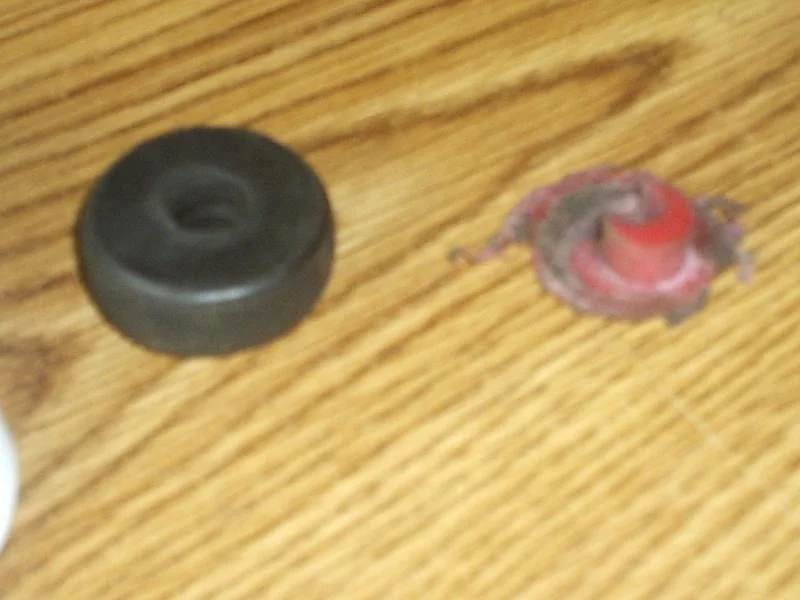

Bushings fixed.....in my special Mickey Mouse kinda way. I was able to find some used rubber bushings in good shape from a club members shop, new ones were about a week away if ordered.
When I took the old ones apart, the bottom half of the bushings were "ok" (compared to the top half anyways), but the top half was pretty much worn down to nothing (see photo-the red urethane was the old top half).
There were 2 indented washers (keepers SOR calls them up as keepers I think), but nothing that I could see that would center the bushing/shock assembly on the oversize hole of the shock tower.
The exploded view on the SOR refers to a part I'm missing or was redundant with the rancho urethane bushings.
Anyways, I just sandwiched them together without a middle centering device. We shall see how that works out.

It won't work very well. You need the correct metal centering washers. Give Dan a call and order the washers and new shock bushings. That way you can fix it right and move on.
