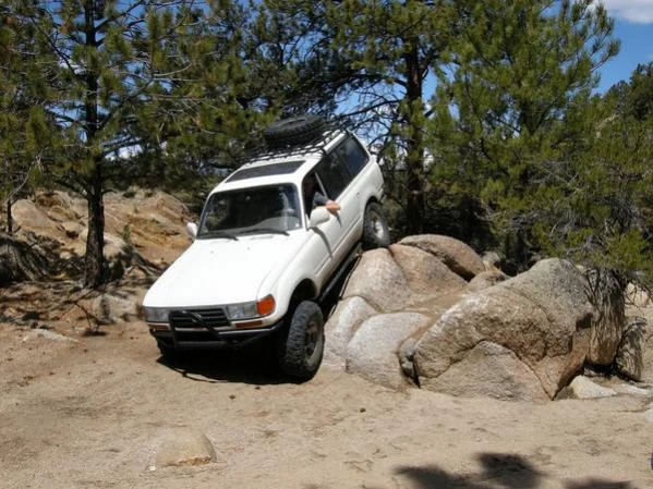

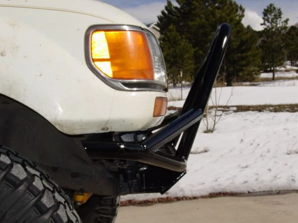

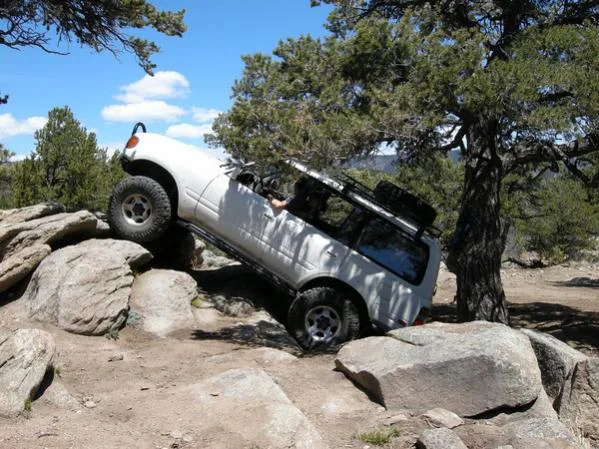

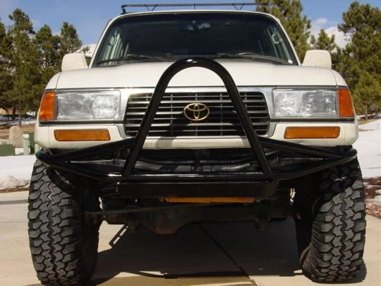

Why can the Slee not take a deer hit? It holds up better in the rocks than ARB. I'd rather have my bumper for large wildlife because the stinger will ensure the animal doesn't get flipped over the hood and through the windshield. That will kill you.
People who whoop the ARB in the rocks bend it. The idea is not to try to turn your front end into a rock grinding tank, it's to gain clearance so you don't have to constantly overcome bumper/rock contact.
This was custom work for $450. My approach angle in front of the tire is easily superior to a 6" lifted 80 with an ARB. It can take a whooping in the rocks, but it doesn't need to, because I don't hit it much. There is no material added weight, and you can run a winch while retaining all that clearance. Now, you may hate the way tube looks on an 80, that's personal preference. I hate weight and limiting my approach angle.
Take a look at the third pic. I'd be starting to dig a hole with an ARB, and would have been grinding it into the rocks on the way up. I've never understood how that is an advantage.

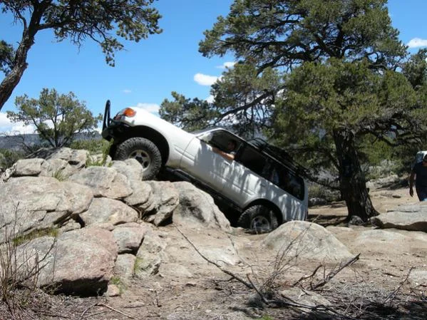

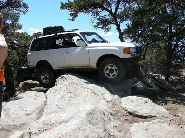

And on this climb I could climb straight on with no bumper contact - the pictures don't show it, but this was steep enough that even with my highly trimmed rear bumper I couldn't back off. It makes an enormous difference vs. ramming stuff with an ARB and hoping it will climb, or sometimes even worse being forced around a rock leading to quarter panel damage.
Obviously the ARB/TJM can handle rock scraping, but it you know you are going to be making a lot of contact then trimming clearance are a no brainer.
Of course, as pic #3 shows, in breakover angle there is no substitute for lift and tires.
