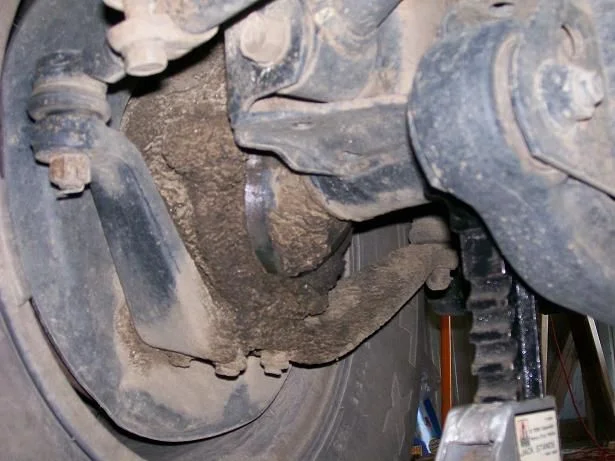

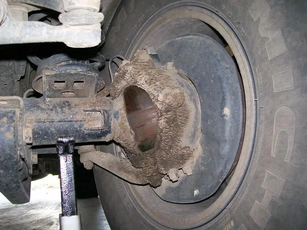

How bad are these birfs?
I already have my stuff from Cruiser Dan to do the axle rebuild but just haven't gotten a weekend yet to do the tear down & rebuild + i need to get a FSM.
SOO - how bad are these birfs? Should I even drive it around? Its DD and she wants to take it on a trip this weekend.
The 450 steers fine and there are no weird sounds from the wheels - last nite I even set the 450 on jackstands all the way around in my shop so it could be put into drive and I could listen to the rotating wheels while it was steered lock to lock for any noise.

It's tough to say without more info. Ultimately you can't tell until you take the knuckle apart.
When was the last knuckle service done and by whom?
Did you peek inside the hole with the square plug on top of the knuckle to see if there is any grease and or diff fluid in the knuckle? There really isn't any way to get grease inside the birf housing without taking everything apart. But I have heard of people just dumping a bunch of new grease down the square plugged hole in hopes that a birf bathed in grease would possibly gain some grease to buy them some time before the rebuild.
Do you have any clicking when ou turn?
What does your diff fluid look like? Grease contamination due to failed axle seal?
How far of a road trip are you planning on taking?
I was told by a reputable source on this board that is would be ok to fill up the knuckle with grease in order to make the 1600 mile trip back home to do the knuckle service when I was concerned about my birf's needing repacking. This is not ideal and can be a gamble depending on how bad your knuckles need servicing.
When was the last knuckle service done and by whom? who knows, we have owned it the last 50K
I wasn't aware of this option - i'll have to look
Do you have any clicking when ou turn? no
What does your diff fluid look like? Grease contamination due to failed axle seal? didn't know to check, will do today.
How far of a road trip are you planning on taking? 500 miles all highway
how long did this band-aid fix take - the axle rebuild will take place in the next week or so.

Couldn't take too long. Remove plug, insert grease, close plug... Repeat. Step 6. 1/2 hr tops?

Agree. Pump some moly (1/2 to 1 tube per side) in through the square plug atop the steering knuckle and take care of the axle service in a few weeks. You should be fine.
Take some HD degreaser and spray both knuckles heavily then take it to an environmental recycling station (or maybe a car wash but I would never do that myself ) and have them collect the old grease for proper recycling. That will make your job a lot easier when you get to the disassembly and cleaning steps.

Clean em up ,fill with grease ,you should be fine for the trip.I have seen much messier /leaky birfs that were ok after rebuild. I recommend Marlin Crawlers seals.

I greased them up - almost a full tube! (about 140 pumps per birf!)
That should hold for another week until I can do the whole job right!

I'm no expert, but those look more dry than wet from failed seals.

The birfs were REALLY dry!
