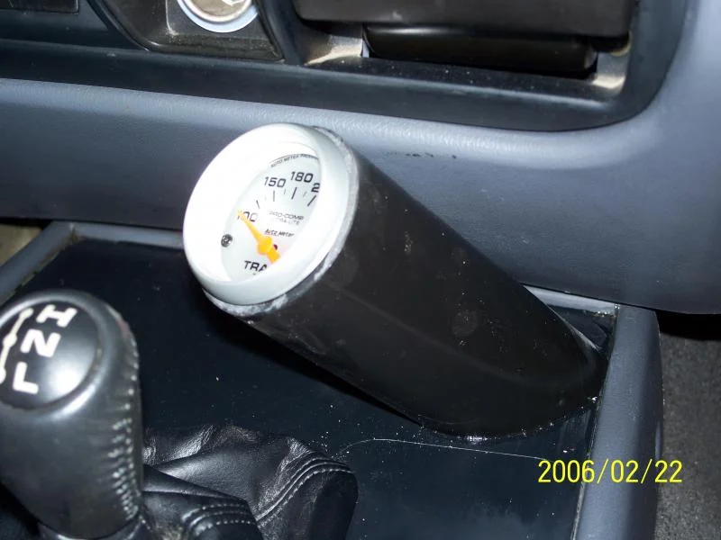

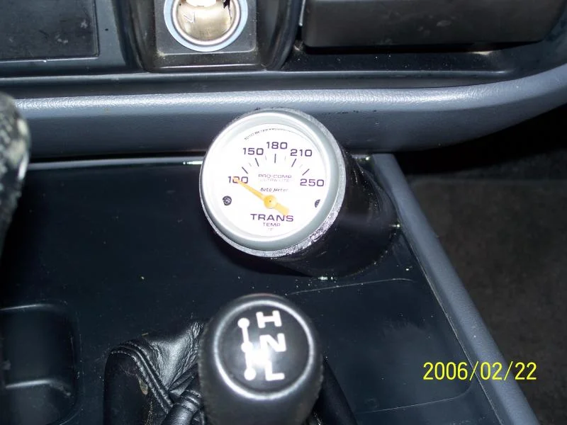

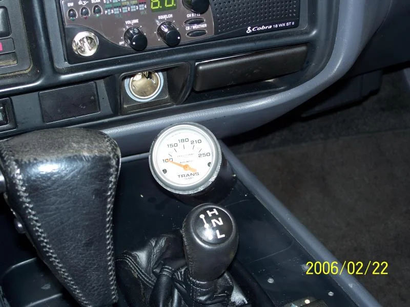

So today I took on this project becuse I need a place to mount a third gauge. I have a two gauge pod alreday and needed to mount this tranny temp gauge. I looked around a came up with using a piece of abs pipe I had in the garage, the gauge fit perfect. Cut it to an appropriate lenght and added an angle cut at the other end, 45 degrees.
By removing the four screws the pamnel came out quickly, I drilled a hole at the base in order to run the wires and with some black paint and crazy glue there you go...cheap easy gauge mounting..

It is a friction fit just like a guage pod.,...stuff it in and away you go...
