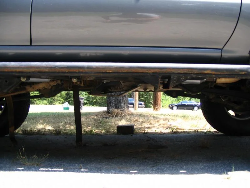

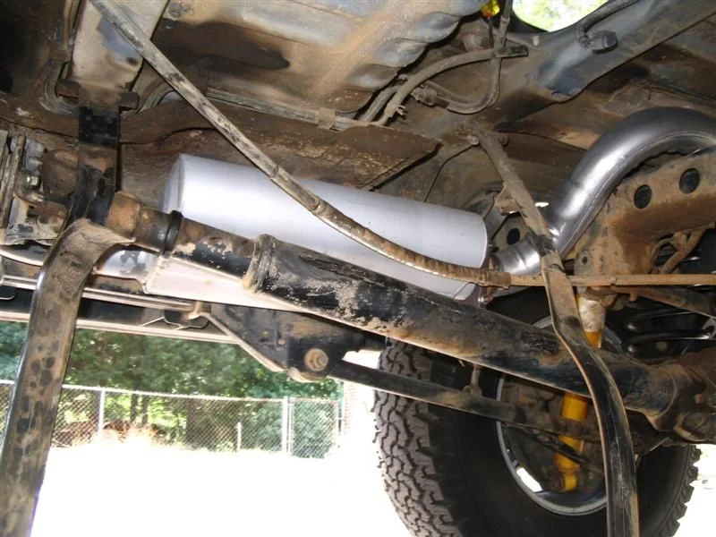

I really liked this shot. It gives a good idea of the ground clearance gained for the exhaust. The side heat shield that hangs down beyond the body pinch joint has been removed.
Here is a shot of the tight clearance between the frame and the exhaust. There are rubber insulators on the exhaust hangers, but there is less flex than needed for the exhaust to touch the frame here. There is enough room to gain a little more clearance than what I achieved. I could go back in the future, if needed, and redo the small section from the cat to the band clamp in this pic. I don't think it will be an issue.

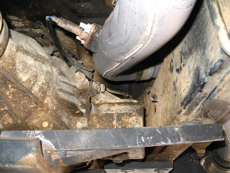

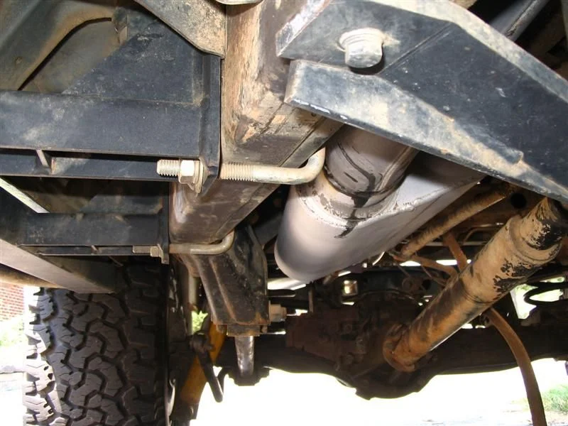

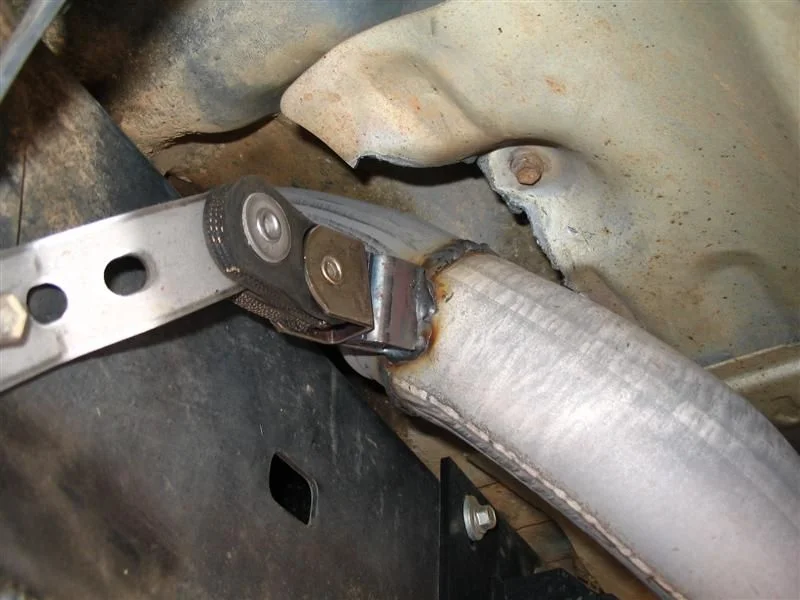

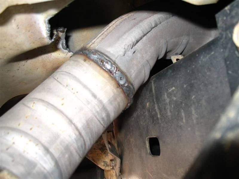

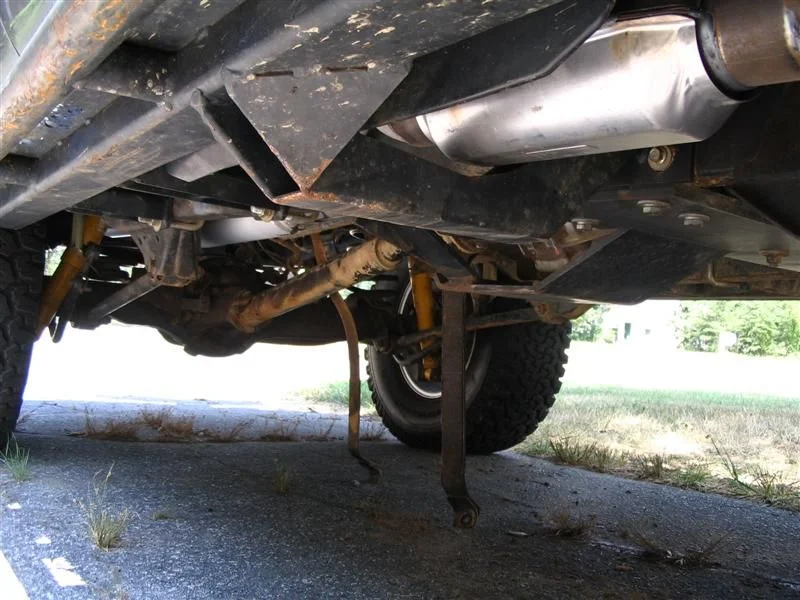

went out and snapped some pics of jfz80's 3 inch exhaust. His is over the frame rail. The guy said that was the last time he will do it since it was such a b!tch to do His gas tank is out that is why i got that one side shot.
His is kind of loud and needs to add a resonator.

couple more pics of his 3" exhaust.
