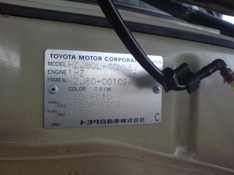

alberta or sask. can anyone tell the year by the vin tag? id hate to drive all the way back to see it again if its newer than 15 yrs..

Its weird the VIN tag doesn't have the mfg date. On my HZJ80 Aussie spec, its next to the A11

Hi there, I'm the guy who recently bought a 92 HZJ80 in Ottawa. On my truck, the firewall plates don't show the year of manufacture. However, they DO show the full 17 character VIN (which starts with JT111...). When I punch that number in my downloaded EPC, it returns me a date of manufacture of March 1992, and the model year (1992). With my truck came some paperwork of previous ownerships in the UK, and they all attest to it being a 92. There is even a letter from Toyota Belgium (where the truck originally was sold) confirming the build date and first registration date). In my case, I bought a vehicle that someone else imported and had registered in my province, so the licencing was not an issue at all.
I can't see the 17 digit VIN on your plate, or else I could check in the EPC and tell you what it says.
By all means, you HAVE to make sure you have legitimate documentation that attests to the year of the vehicle before you bring this back to Canada, or could be in for a very nasty surprise at the dock!!! (ie. crush or send back).

Yup, according to the info I have, it's a Feb or March 92 production.

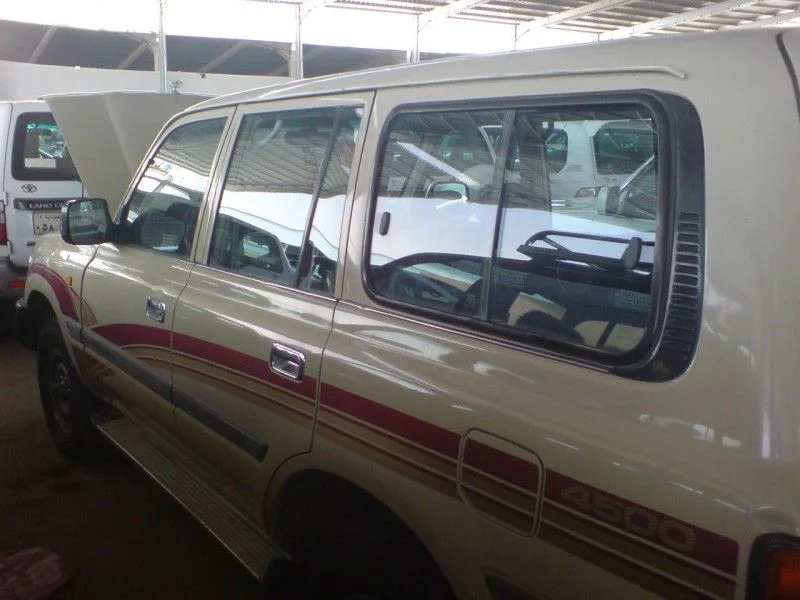

Whats with the 4500 (gasser) decals on the side?

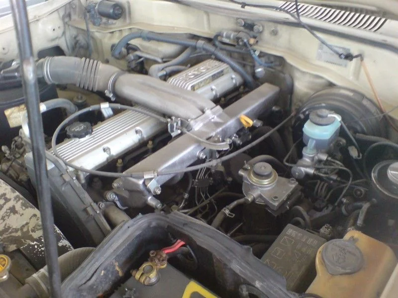

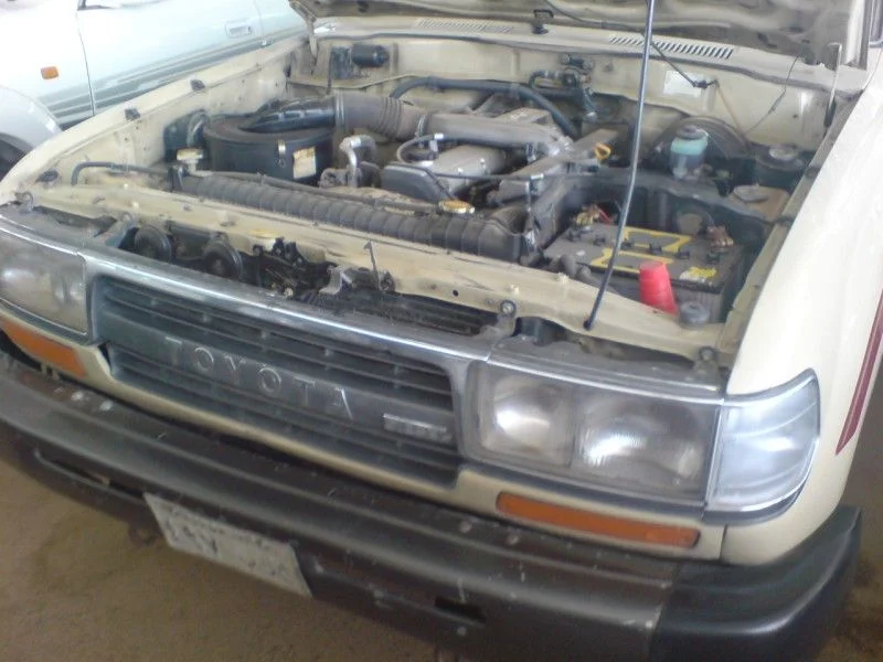

The truck looks alittle suss to me. It has a 1HZ in what appears to be a petrol body. The power steering fluid reservoir is not mounted at the typical RHD HZJ80 point, ie between the timer belt cover and the fuel pump, but this could be done to all LHD.
The tell tale sign of a HZJ80 would be to look at the front grill, it should say 'Diesel' under the 'A' of the 'Toyota' logo.

Good eye! Indeed the power steering fluid reservoir is not in the right place. On my LHD 1HZ, it's where you describe it for RHD: between the timing belt cover and the fuel filter. So indeed, we may be looking at an engine transplant job here, which would account for the misleading stickers on the vehicle.... Caveat emptor...

I reckon the best way to really get to the bottom of it is to get actual photos of the chassis number located at the LHD driver side of the wheel well and try matching it with the VIN tag.
This cruiser may be a put together piece which is quite normal in many parts of the other less developed countries.

2.the VIN's here are all like that on every cruiser ive seen of all years and types..no mfg. date, no door tag. i havent been back to check the frame number. theres no service records. but i will double check for vin's.
3. does the motor need rebuilding? i really dont know. seemed to smoke alot, but then i am not familiar with how much smoke is normal..ive always driven gassers.
4.parts. i was thinkin the same thing about chassis parts, and ens is in my neck of the woods. thanks rstl99.
5.the gasser emblems and p.s. reservoir. i know that on 40's and 60's, ac, ps, alt are all mounted differently out here. maybe 80's are too? the emblems..i have no idea why. i was expecting the tag to indicate gasser, but its not. im qiute sure its not a RHD conversion as the wipers are in LHD position.
6. i did get a pic of the grille. it was the diesel emblem on it that caught my eye in the first place..
