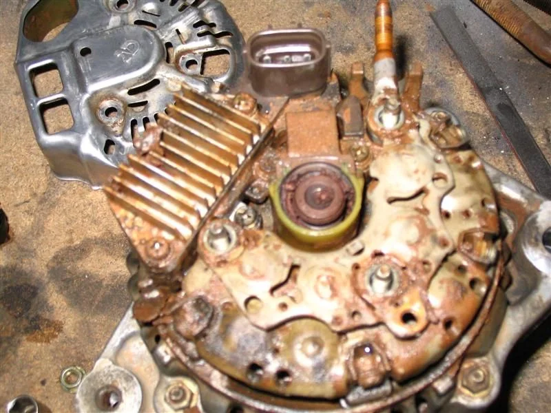

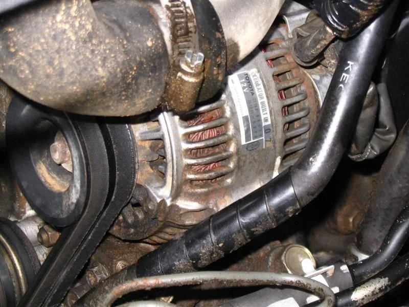

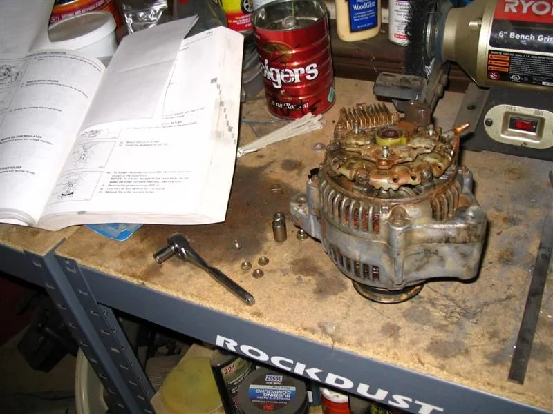

no wonder my alternator was not working!! WTF! look at all the mud/grease/ATF fluid that had gotten into this thing!
First removed the battery box and battery. I have it on a trickle charger right now THen unbolted the PS resevoir for better acess. Also pulled the dizzy cap for better access too. Might get a replacement rotor while i'm in here.
I'm going to clean it up better tomorrow with some carb cleaner. THen put a new "brush" in it.
Pics of getting to the alternator along with all the sludge problem i have.

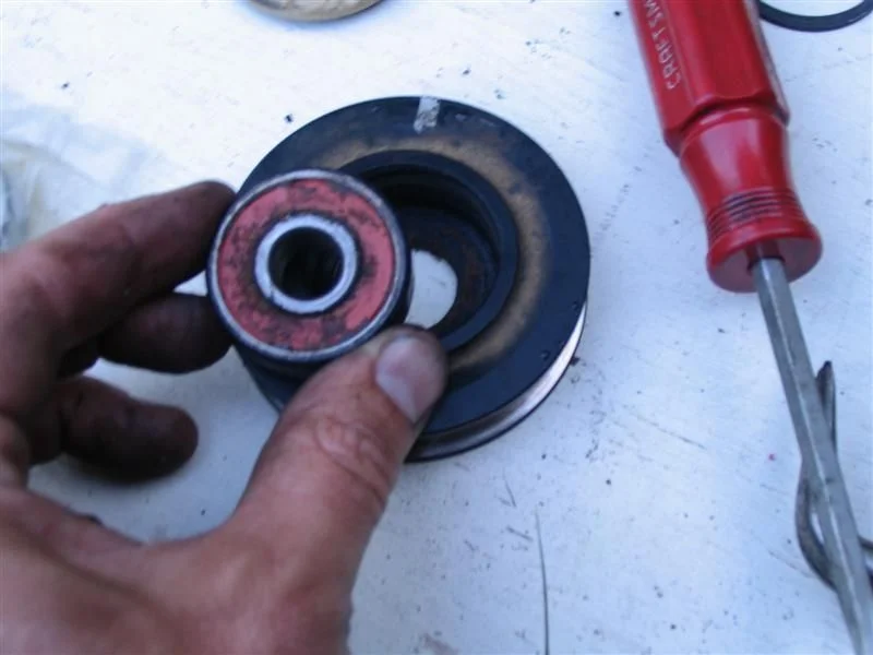

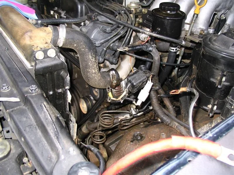

couple more pics showing the gunk buildup.
I also replaced the AC idler pulley bearing while i had the belts off.

OK, cleaned it up really well. Put new brushes in and re-installed with new belts. Scangauge says i'm charging at 14.6 volts. That is at idle. Sounds about right, and the dash light is off!
The biggest pain is just getting to the Alternator. The battery box has to come out along with the battery. The PS reservoir has to be moved also.
