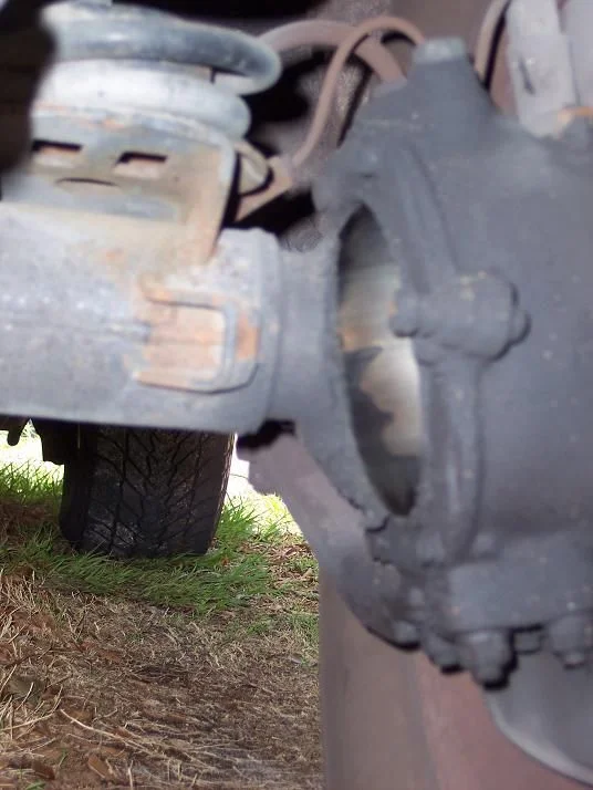

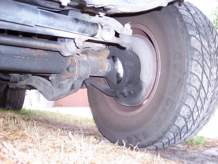

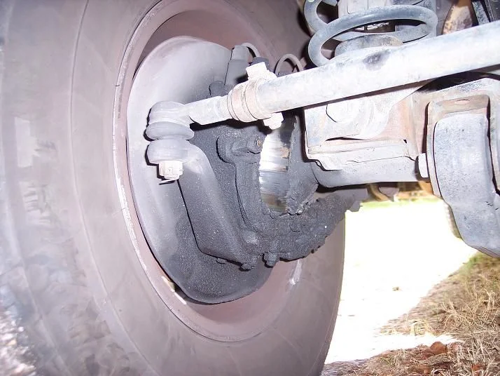

Pics of axle
Thanks for the post, here are the pics of the passenger side wheel/axle:

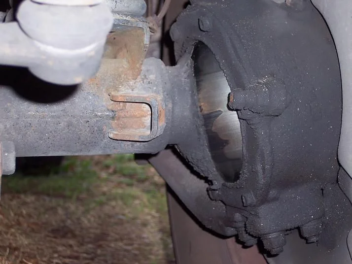

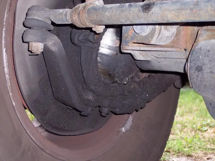

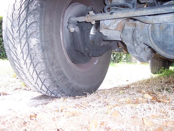

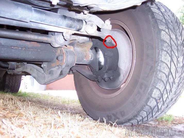

...and these are pics of the Driver side wheel/axle.
Yes, noise. I am hearing a clanking/clicking noise when I turn the wheels...mainly making a left hand turn. Tires are wearing bad on the left front wheel....4x as much. Other than that it is hard to say. I need to get tires as well because of the uneven wear, so it's hard to say if any of the other road noise is not just the bad tires.
Thanks again for the help!

Yeah, you need a knuckle and Birf rebuild with new knuckle bearings............

As calstyl said, you need a knuckle job. Sooner rather than later since you mentioned the clanking/clicking noise. You might as well do the brake pads at the same time. Parts from cruiserdan will run you around $220 plus $60 or so for the brake pads. You'll need another $40 or so worth of grease and oil. I'm too far away or I'd be happy to help. Have you tried asking for help in the Florida cruiser club section? Here's a link.

Do some search on here for what type lube. You can put some lube in the square hole for now.
You can also get DVD on how to do front job. Do a search on it too. Good luck.
