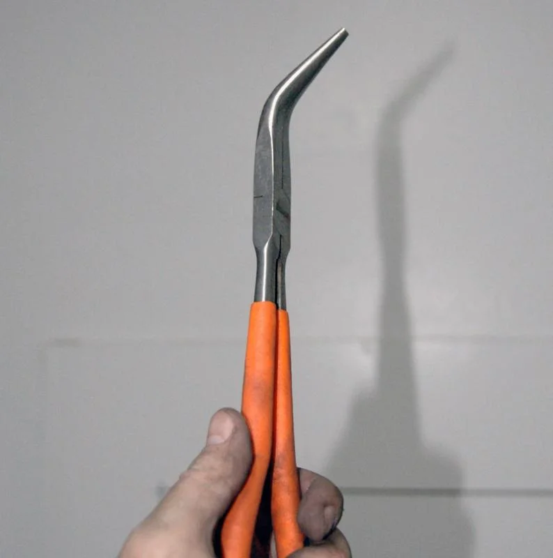

The real hero is this pair of angled pliers.

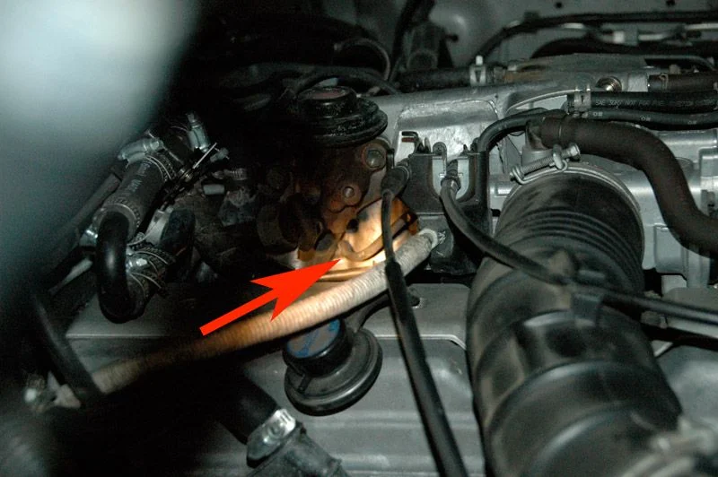

First off it is IMPOSSIBLE to reach this going from the driver's side. No way in hell I don't care what gets removed. I instead removed the EGR modulator and saw a hose which you see in the pick (arrow). THAT little bastard is the hose I needed. Well... I needed to remove the modulator bracket to get my hand in. Trying to pull the hose off with my hand while balancing on a step stool was pretty close to guaranteeing I was gonna impale myself on the threaded rod of the air cleaner.
I used the angled pliers and grabbed hold and the hose slid right off. The drill bit, amazingly, was still stuck. So I used a tiny allen wrench to push it there and there it popped out!!!!!!
Of course now I have a vacuum leak where the drillbit had pushed through the vacuum hose from me being a complete retard trying to push the drillbit through. I guess I will get some tomorrow
CASE SOLVED!!!!
