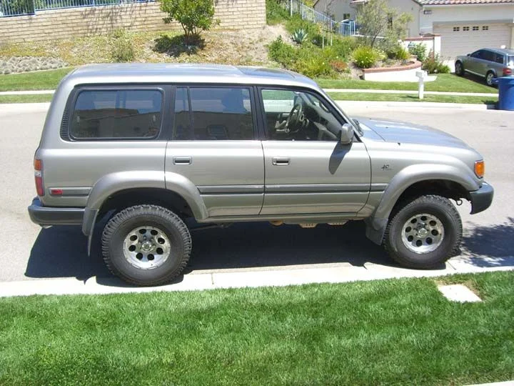

Hey JGolden, Below is my 97 LC... It has Downey springs, 2-3in lift, 295x16 BFG's (approx 34in), custom 2.5 shocks using stock mounts - one per corner (with Fox pistons & King by-passes - 10in stroke - must use weld top shocks with posts), 3in Light Racing bump stops on each corner (they were tricky to setup cleanly). Also replaced the tank with a 38gal unit, stock unit was on fumes one lap around Parker. Selling it to JLoth...I've been playing with it for 10 years, let me know if you have any questions. Allen

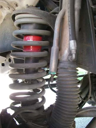

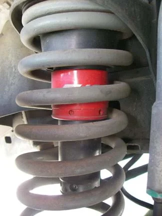

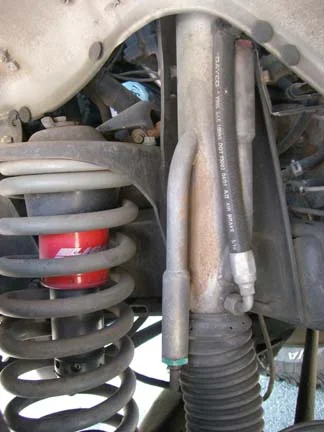

For those of you interest, below are pics of the Light Racing bump stops on my LC. On the front, I sandwitched a mounting plate between the coil carrier and the top bucket mount. Cut the top coil carrier and used it as a spring guide to keep the spring from moving around. I also reinforced the bottom axle spring carrier with plate just in case. Fab not too complicated and basically bolt on.

The rear is a lot more complicated. I used the 3in versions on the back, but highly recommend using the 1.5in version if you want to attempt. Also the back moves sideways through the cycle, so you need to check clearances until completely compressed. Used a top plate and welded at the upper most part of the top spring carrier (also needed to cut a hole in the top spring carrier to fit the bump stop). The bottom axle spring carrier need to be "hollowed" out and the bumps actually compress on the axle. (this is the main reason to go with the 1.5in versions). I would have now if I had known, but I had to try and fit the 3in...

Light Racing Bump Stop Recap: These work great and allow you to set your suspension up soft/plush with only 10in of travel. Really progressive and without a harsh initial hit. I have not tested the bump stops with other shocks, but I think they work so well you probably don't need large bodied shocks (if you can keep your shocks cool enough) for all but extreme prerunning. Definitely makes the by-pass shocks un-necessary.

6-6.5" up travel, 3.5-4" drop. The suspension is setup soft, always using the entire travel stroke in offroad conditions. The trick is to have the high-speed rebound as light (fast) as possible to keep the tires on the ground. Makes a huge difference in ride quality and handling. I actually tried going heavier (slower) on the rebound once during a revalve and made the ride a lot rougher on the vehicle and driver
