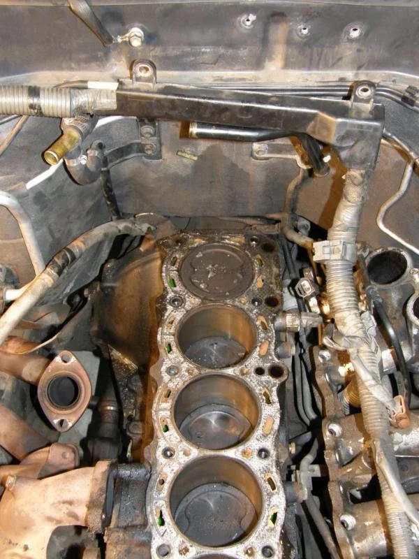

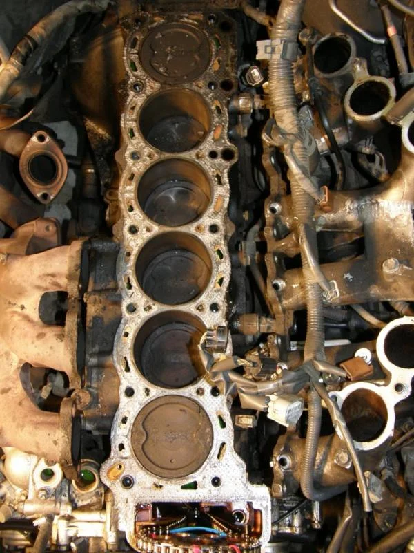

I finally got the head off today! It has been fairly easy until today. I broke one 3/8 Snap-on rachet, and one long 3/8" extension trying to get the nuts off the front "Y' on the exhaust manifold. Never did get the nuts to break loose . I had t remove the studs from the head so that I could lift it out. I also removed the studs from the head to get the rear exhaust Manifold off.
Hopefully I didn't mess anything up by removing the studs and that I can reuse the ones I took out????
From the pics you can see that the head gasket did not appear to leak internally. Which from what I hear is not to common. I drove this for a least a month with the leak so I am sure the piston would be washed if it was leaking internally.
There doesn't appear to be any ring grooves on the cylinder walls so that all looks good. Unless Robbie or Doug can see something with their experienced eyes that I am not seeing.
All in all I am pretty happy with the look of the internals since it has 200k.
Tommorrow I will send the injectors to Witch Mountain, and will take the head in to have it gone through. I figured I would have everything done on the head while it is out. Cleaned, checked for cracks, new valve stem seals, valves re-ground, shaved if needed, etc... The owner at the head shop said that it should run me around $650.
I have a new water pump, blue hub fan clutch, brushes for alternator coming from Dan. So I will be busy cleaning and installing other parts. I also have a new P/S pump and hoses to install while it is easy to get to.
I will post more pics soon..

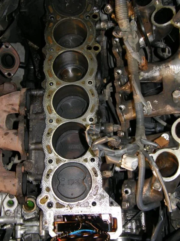

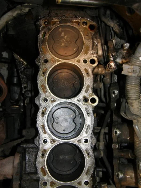

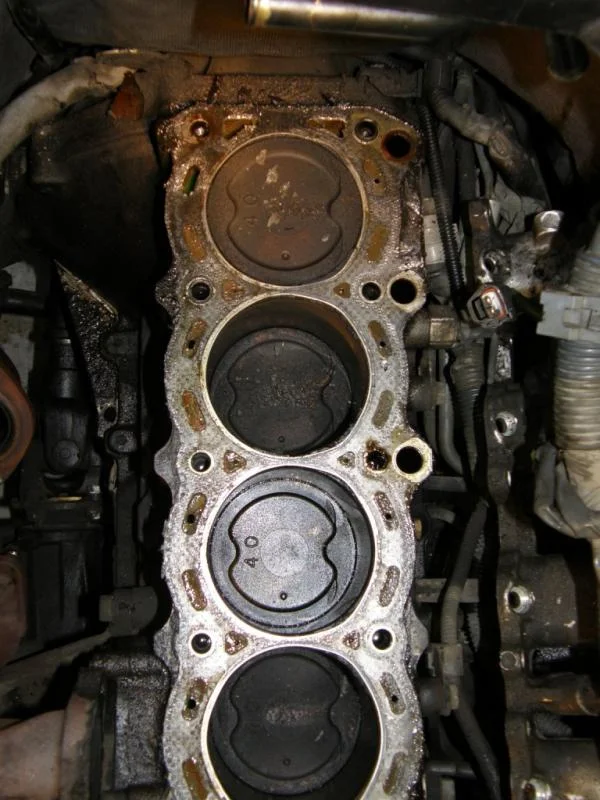

More pics
Close-ups. You can see the fire ring is deformed on a couple of the cylinders

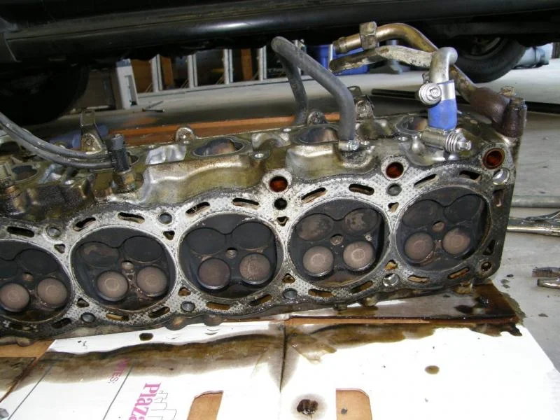

Head gasket removed
