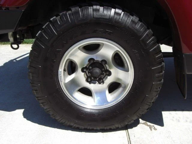

The way I ID them usually is that the wheels are different (4 kinda double spokes and 15" rim on an FJ, 5 spokes and 16" rim on an FZJ)

Could be a few quick ways, Engine, wheels, IIRC 3rd row seats, VIN should tell, That or the door sticker
Wheels..
FJ80 has dual four spoke, FZJ80 has a 5 spoke

As Cory pointed out, the wheels are the easiest way. Next is the flares; they are different (narrower) and a few FJ80s were flareless. Then the tailpipe is on the left side and they are a little bit "taller" than an FZJ80 but that is really hard to tell.

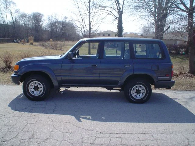

I believe the 3rd row was an option on all 80-Series; FJ80 and FZJ80. The picture of the FJ80 that Cory posted has 3rd row seats. Maybe it is an early FZJ80 with rear drums and retro-fitted FJ80 wheels but I'd bet it is an FJ80 with 3rd row seats as an option.
FYI, retrofitting 3rd row seats in an 80-series truck that didn't have the option is a major hassle. The cargo area is built differently and the brackets DO NOT bolt in. I am sure someone could do it if they wanted but it is non-trivial.
