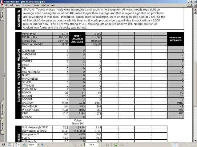

Blackstone UOA 5015 Miles W/ M1, W/Turbo
Excerpt from my most recent UOA (Cannot finger out how to post the whole report - converting .pdf to .jpeg?):
"""Toyota makes nicely wearing engines and yours is no exception. All wear metals read right on average after running the oil about 400 miles longer than average and that is a good sign that no problems are developing in that area. Insolubles, which show oil oxidation, were on the high side high at 0.6%, so the oil filter didn't do quite as good a job this time, so it would probably be a good idea to stick with a ~5,000 mile oil run for now. The TBN was strong at 3.9, showing lots of active additive left. No fuel dilution or coolant was found and the viscosity was normal."""
This was the first time I have ever had the oil up to 5K miles. Prior to that 3K to 3.5K was what was scheduled. Looks like the oil did super well but it also looks like they are blaming a bit of oxidation on the filter? I only use the 20004 and cannot see how that was contributory, but in any event, assuming the oxidation is okay, it looks like M1 can easily handle a forced induction 1FZFE for 5K miles. I think this also proves that the 7.5K or even the 10K schedules some have here would be too much for a forced induction 1FZFE. Anyways, just thought I would share something, any thoughts on the oxidation? Thanks.

I should probably also make a mention that the engine is at 162K and that I ran a can of BG 44K through the system from 4500 miles to 4750 miles and the analysis was at 5015 miles exactly. Also my last TBN which was at 3000 miles was 8.1!!! So, the 3.9 at 5015 I think shows that the additive package will probably wear out way before a 7.5K or 10K change at least on a forced induction 1FZFE. Anyways, just for your enjoyment...

Not too much life left - I think that anything below 2.0 is risky right? I keep forgetting the new measurement method that Blackstone uses but there's big difference between a TBN of 8.1 @ 3K miles and 3.9 @ 5K miles!
My turbo is BOTH oil cooled and coolant cooled (and actually also "air cooled" in the way that the two heat shields are situated and louvered). I also have and really religiously use a turbo timer to prevent coking or cooking (two different things) the oil so it is almost all exclusively the extra heat whilst in operating mode as opposed to a small volume of oil getting ruined in the turbo at each and every shutdown. HTH

RT, now that I paid more attention to it, I realized I created the same amount of insolubles in 5K that you would have had to drive 11K to create! Are you sure that sounds "normal." Never had this till I went to the 5K interval. I'm wondering whether 3.5K is where its at for FI???
depends on which run you are talking about, on the 4K run I made .4 in, following that logic I would get .6 in 6K but I only got ,5 in 10K.
In oil analysis you do not worry about noise, if something is truly wrong it will be immediately noticeable and well out of normal ranges, not quibbling over two tenths of a percent (.002)
