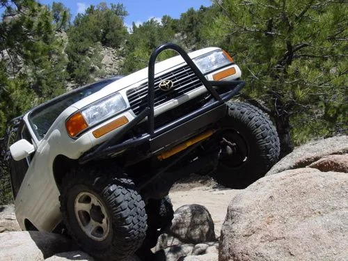

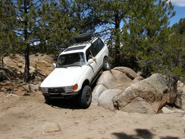

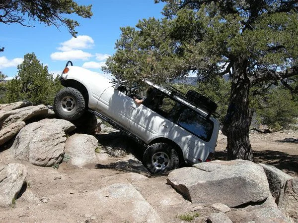

How about staying at 3" and running 35's? It's not a real lift, but hey, a guy has to give up something every now and again
Oh, and it rides like buttah
