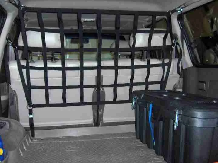

Which model did you get? I sent Raingler my dimensions 18 months ago and Eddie recommended the "RBN Jeep SUV" model. Yours seems to provide a little better coverage than mine.
The net we tried was the "LRBN Land Rover Discovery Barrier Net". So I guess I've have a little British DNA injected into my LX now . Anyone have some Grey Poupon?
I don't know if Eddie has any plans to make any changes to the LRBN net as it morphs into an 80BN net as well.

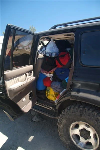

Just a quick update...
The net was used on a recent trip to California to run the Rubicon during TLCA's annual Rubithon. The trip was a BLAST and the net did great. See the picture below. The net really is there, you can just barely make it out in the picture. We found all sorts of useful things for the net to do aside from just keeping stuff in the back of the rig - It came in handy to tie stuff to it and to hang stuff off of it.
I can say the net has been Rubicon tested and did its job well :drive:

It looks like crutchfield.com sell these nets, but I think I got the last "LRBN Land Rover Discovery Barrier Net" in stock because it now states that they are discontinued. I bought mine for $86 shipped. They must have been on clearance or something. They still have the roof rack nets.
I still need to get the extra straps to make it work. Does anyone remember how much they paid for the 4 extra straps from Raingler?
Their website is down, so I may have to just buy a few clips and webbing from a sporting goods store.

Very cool. Does anybody know what rating those clips are at? A medium dog (40lbs.) at 40 mph does generate some energy in a quick decel. (Read collision or accident avoidance).
I'd like to know before I buy.
Good score on the net for that price
As for the straps, the website is up now and per the site the extra straps are $3 for the 2' long straps and $4 for the extra long ones (no actual length given). I don't recall which ones I bought but I'm pretty sure they are the 2' long ones.
Quote:
I believe this is the answer to your question:
RTD Tie Down Strap
Same construction and materials as our nets. 800lb military buckles with 1,000lb. 1inch wide 2 foot long 10 year UV resistant webbing.
So the buckles are rated at 800lbs and the webbing at 1000lbs. Of course there are multiple buckles and straps so the force of anything trying to push its way past the net is spreadout.
