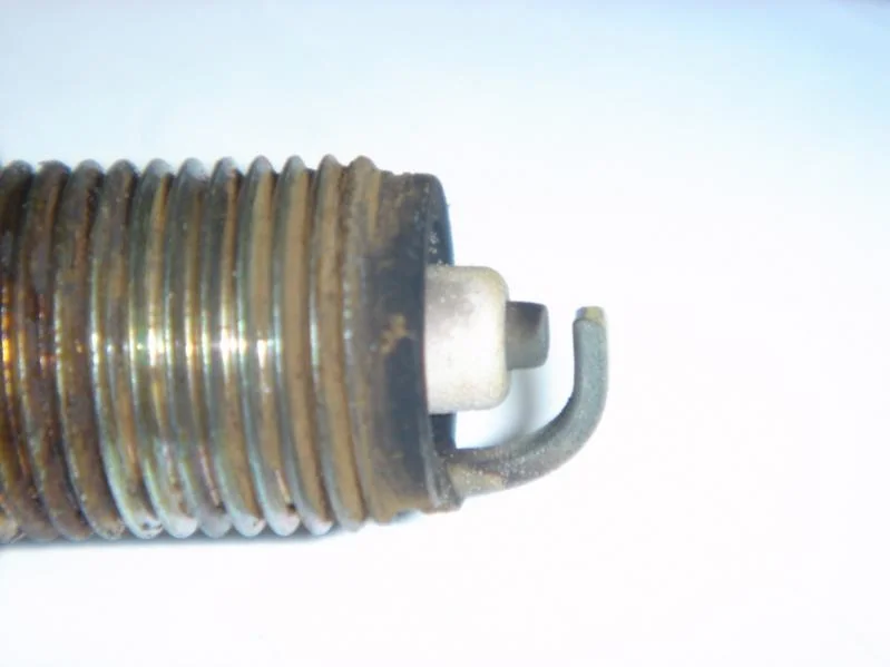

it worked for about 1 week, I got 19 mpg on that tank with all city driving but I cannot figure out why it is doing this it keeps destroying computers I have done through 2.
Ill take some pics of the plugs its time for me to tune up anyway.

Dude, whilte your taking pics of the plugs, lean over the motor and get pics of that cool install. Thanks!!!

Same plug with and without the flash it looks perfect

Blake,
I am not an expert on reading plugs but this pic appears to show tiny specs of aluminum on the porcelin. Can you get a better close-up?
From two different web sources:
Detonation shows up on the plugs as spotting on the porcelain. There are two different types of spotting seen. One type appears as just black spots and the other appears as little bright spots like diamonds. The black spots (look like pepper sprinkled on the plug) indicate a little too much heat on the plug which causes detonation by having the heated plug fire off the mixture prior to the spark firing. This creates two flame fronts that collide and can cause great amounts of damage. If you see black spots on the porcelain and you know the tune-up is correct then you may need a colder plug. If you are not sure then increase the carburetor jet size slightly, take out some timing, or go to a colder plug. If you hold the plug in the sun and you see what appears to be small diamonds on the porcelain then your detonation is severe enough to be blowing off the aluminum from your piston and you need to add fuel and/or take out timing now.
and ...
The third thing to check is the porcelain color and this will clue you into preignition/detonation issues. What you're looking for are tiny specs of aluminum on the porcelain, which can be either black or shiny. If the tip of the insulator appears melted, then this is yet another clue to a pre-ignition/detonation problem. The detonation is caused by the air/fuel mixture exploding instead of burning and you may hear the resulting knocking sound from this, particularly when the engine is under a load. The knocking sound heard is actually a shock wave that's disrupting the boundary layer of cooler gasses that cover the internal parts of the combustion chamber, resulting in incomplete combustion. This rapid rise in pressure and temperature exerts extreme force on engine components and can do very bad things such as crack your engines head, crack or put holes in your piston, blow head gaskets, break your connecting rod, damage bearings, seals, etc. This is why you should not base all your jetting decisions on just the porcelain color alone because the porcelain color doesn't tell the whole story. Although the porcelain and base ring colors are similar, the porcelain usually appears lighter in color when compared to the base ring.
(emphasis added by me)

with the picture blown up to about 600% (roughly 15X magnification from a "real plug" at eyeball) it looks "normal" to me (it starts losing "definition" at full screen on a 19 inch monitor). Minimal evident wear on the center electrode and just a tinge of metallic color on the insulator. If that plug has been operating in a detonating condition, it hasn't been doing it for very long. Generally, on "over hot" plug (one that STAYS hot perhaps almost to the point of "glowing" to cause pre-ignition) will show a lot more indications than this.
How many miles on the plug? Based on possible erosion around the corners of center electrode, I'd guess 15k? You said this was out of your "gadget" equipped vehicle - curious question - you use tap water or distilled? Since I see you are in Central Calif - if you are using tap, the dissolved minerals might be showing as those slight green deposits on the insulator. Green is usually a sign of dissolved copper, perhaps a slight copper chloride content
