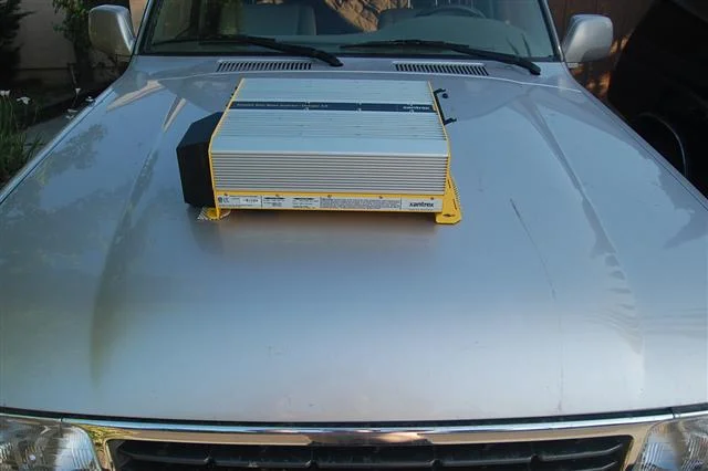

I just scored (and I mean SCORED) an inverter from work today. I've always wanted a bigger inverter than my little portable but I'm not 100% sure why I'm curious what types of things you run with yours, if you have one.
More importantly, I'm looking for ideas as to mounting, extra outlets and other creative aspects as they relate to an 80. I know that Hayes has done quite a bit with his install but hopefully I can get some more input prior to taking on this project.
If you're interested, here it isXantrex Technology Inc. - Boats - Prosine 3.0 - Product Information. It's a Xantrex Prosine 3.0, pure sine wave 3000 watt continuous with built in transfer switch and charger. I got it for $100 because it is missing the controller piece and was written off.

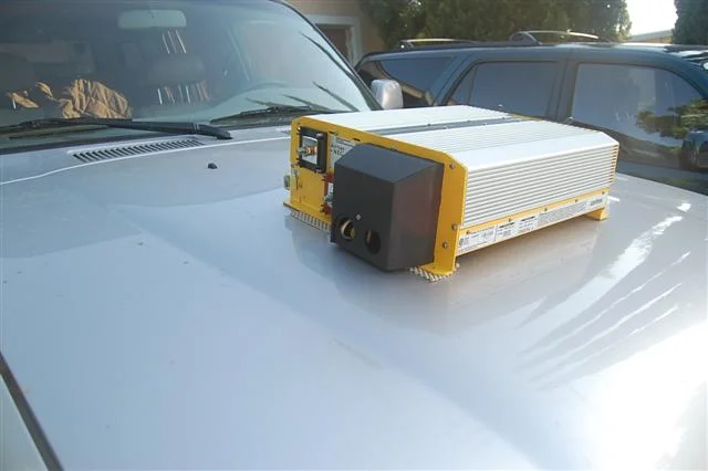

Anybody got any recommendations? I unboxed this thing and I'm a little worried that I may have a little more inverter than I need. The recommended cable is 500 MCM which appears to be a couple sizes larger than 4/0 I have no intention of running this thing at near capacity but you never know. Dual batteries have been a part of my long term plan and maybe now is the time. I'm thinking of 2 group 31's. Too may projects, too little time (and $)

Your inverter is rated at 3,000 watts continuous power, which means it draws almost 300 amps (!) continuously at full power. (3000W / 12V / 0.85 efficiency factor = 294A) Even with two group 31's your batteries won't last very long. And the alternator in your LX 450 won't come close to producing 300 amps. This is a monster inverter. On the plus side, it's a high-quality "pure sine wave" inverter and so, as Robmir says, will power any type of quality electronics. So I think you need to buy a high-end accessory for your rig, say something like an audiophile-quality surround-sound "truck" theater system.

Yeah, yeah, yeah, I know. I have actually been giving this some thought from the beginning. So far, no one has given me a legitimate/quantifiable reason how I can use this inverter to it's potential. Thanks for being the voice of reason. It's just that it is soooo cool.
Here are a couple of pics that I call "putting it in perspective"
