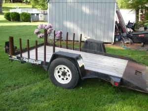

here's a pic. I'm thinking I'll remove the dovetail for better driveway approach. my main hesitation is the trailer alone is #1500 is that heavy for a trailer? My other thought is for $1K I better use the darn thing. I just wonder if it's overkill? Although what a great excuse to have a toy hauler.
This next question may be a trailer tech question. I'm thinking bobcats are evenly weighted. Will a short trailer cause me to die?? because of weight distribution issues??
thanks all
bob

I have a single axle 5x10 trailer with a gross weight of #3600. I' use it to carry a lawn tracter or dirt and mulch. I once had about 3000# of limestone loaded it. It is the perfect replacement for an 8 foot bed and it cost about 800.00 new. I think its a steel at 1000.00 provided the title and paper work are in order.
Now that I see it try 300.00. Not having sides is a bummer. For 1000.00 you can almost get a new one with simailer features and sides.

I think he's asking more cause it's rated for #6900 it has a title and all and was bought new in 2005.
bob

will your "FJ-40" (Jeep?) fit on a 10x6 trailer? sounds tight, If you want a toy hauler would be nice to be able to haul other vehicles also.

nissan patrol
I think the problem comes in at me using this for hauling 2x4's and mulch.
bob

I think $1k was a bit high in price, and the axle looked very close to center. It sounds like you are looking for 2 different trailers in one, good luck.
