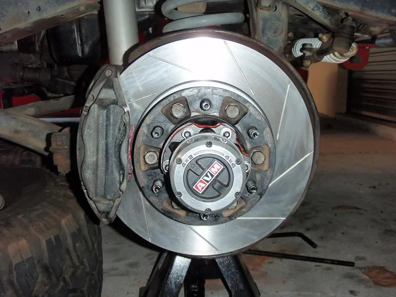

My baby has new front rotors...
Bolted up some new slotted front rotors yesterday to replace the originals. Replaced the pads and front wheel bearings too while i was at it. The wheel bearings took me a while to do, as it was my first time, but it all worked out ok. I love the massive 4-piston calipers on the 80! It's great knowing i'll be able to stop in a hurry now if needed.

Very nice! What brand did you go with?

They are DBA (Disc Brakes Australia) rotors. Picked them up for a good price at a local auto parts store when they were having a sale.
Disc Brakes Australia - PERFORMANCE DISC BRAKE ROTORS
