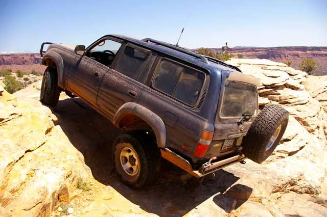

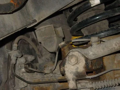

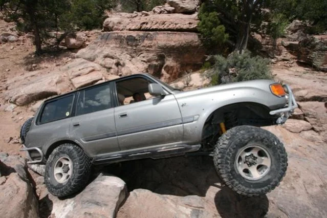

That size is a "35". Probably slightly smaller than my tires, but if you really wheel that tire will rub on full compression on the OME 2.5" lift.
Here is how much up travel was left on my OME 2.5" kit when my tires hit, and I don't have flares. You could extend your bumstops 2", but that's not much up travel for OME, so if you like to travel fast in rough terrain you may not like it. But they certainly "fit" depending on what other tuning you do.

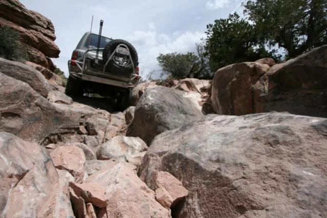

Nitto 315's are great all around tires. They have good highway manners and work well in desert/Moab terrain, have no idea how they would work in the northeast? Both of my brothers run them.
For a big tire they fit well on the 80. IIRC 2" is overkill for the bump stops, depending on your tolerance for touching you can probably get away with close to, if not half of that. By adding 1/4" wheel spacers, you may need even less, depending on the rest of your setup.

Agreed - my bumpstops hit at 1.25" of travel remaining with the trxus on OME 2.5". For a slightly smaller tire, 1" of extension would probably suffice given you have to be fully flexed to get it all the way to the bumpstop.

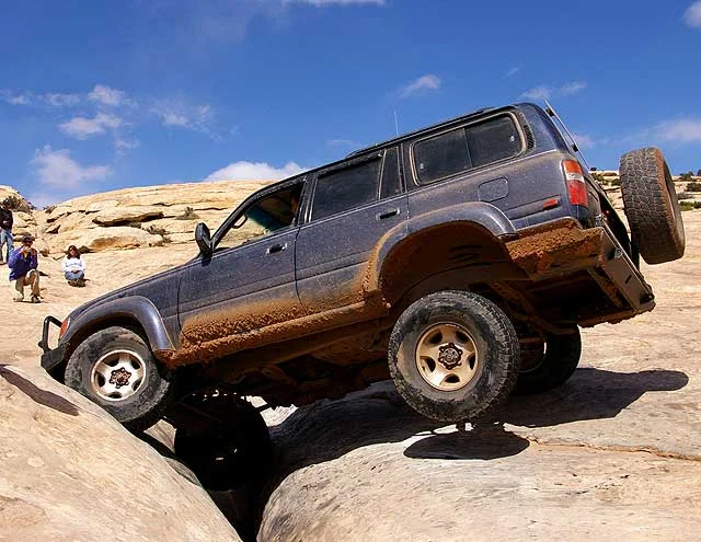

Also the shocks have a bunch to do with it. With the std OME's there isn't much droop, so the stuffed tire is more vertical in the wheel well, making for an easier fit. With L's or longer, the increased droop increases the axle/tire angle, needing more bump/wheel spacer.
His doesn't normally rub, except when it has a good coat of mud taking up the space.
