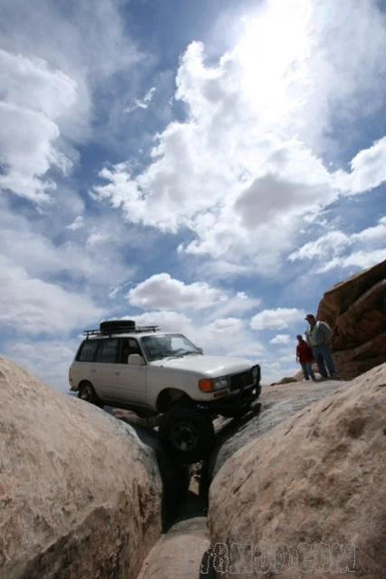

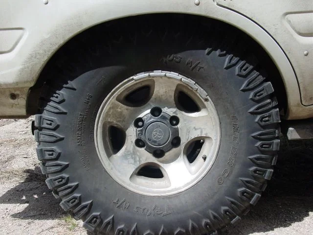

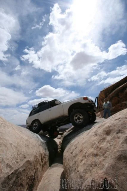

I'd start with tire size - 35's on an 80 due to its size are like 33's on a smaller rig.
If you are talking about trails like Golden Spike, then a 3"-4" lift and 35's is plenty. If you want to go up much from there to run the hardest stuff in Moab, I'd agree on fitting 37's, although that's more a damage prevention measure than pure need given we've seen 80's on trails like Rusty Nail. If you like Pritchett on up, then yea, I'm probably on 37's.
I would also choose between FOR and Slee 4". The reason is both are well balanced in up/down travel. OME J would meet your needs as well, although my personal opinion is you'd prefer the springs of the other two.
The 80 is a good crawler - to a point. It is very well suited to Moab. Trim up front and rear clearance and you are good to go with 35's.
I'm on FOR and 35's and barely scratched the paint on my rear bumper going across the crack - how you deal with bumpers in Moab is really more important than excess lift as most Moab trails call out approach and departure angles far more than breakover angle (steep but smooth ledges, not big rock gardens), so trimming up front/rear and choosing tire size and suspension balance are your key design components IMO.
Pull your flares and 37's should be a pretty easy fit if you want the bigger meats. Last pic is how 35" trxus fit on the FOR lift full stuff.

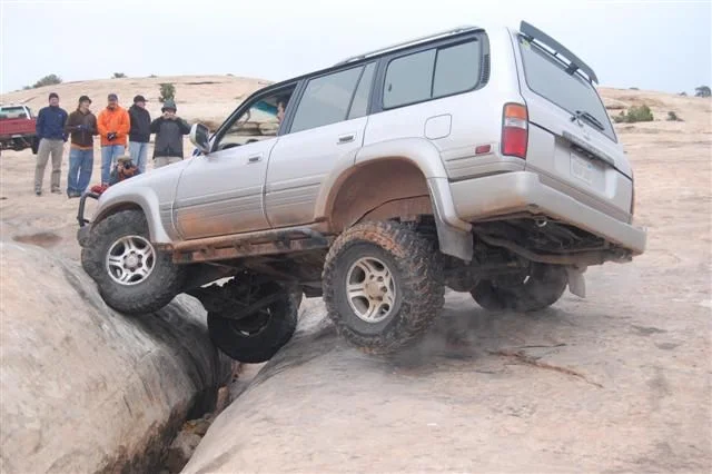

I completely love my Slee 6". I have yet to find myself in a situation that I wished I was running a smaller lift. I will say that Moab is more demanding on a rear bumper than anywhere else I have wheeled. I would go as low profile as possible. Here are a couple pics of my rig on Golden Crack:

This is a good contrast to what I was talking about in designing a rig for primary Moab use. Despite your significant lift advantage you drag your rear bumper a lot worse than I do, because the location of max up travel on the two lifts is about the same, which in this type of flex compresses the suspension about the same. The difference is my rear overhang is much shorter.
In a rock garden things would be different, because my rear bumper clearance would make no difference to getting hung up on control arm mounts, resting on sliders, etc.
Designing an 80 for Moab definitely includes the sawzall

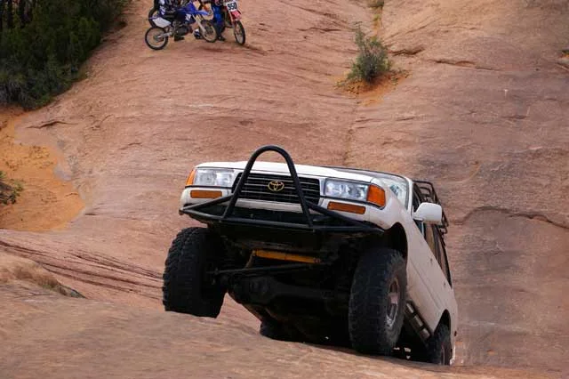

I have run Moab a few times with 33’s (295-75x16), this was the first time running the 37’s. Way happy with them, places where it struggled before, it easily walks over now. Brother Rob’s with the 315’s has historically had an easier time in rock than mine.
Other than my front arms allowing slightly more flex our setup is the same, J’s, L’s & 1.5” front spacers. Our trips usually include a mix of rock play and long distance touring and both rigs are close to stock weight. For our use the OME setup works well, they are soft enough to give a good ride for long days and flex well without unseating. If anything I would prefer a slightly softer spring.

For some reason I was thinking you were on 35's, now I see why you were walking right over everything even with stock gears
Was good to meet you
BTW, I think FOR still has a 4.5" spring if you really want to tinker, much softer feel than OME.

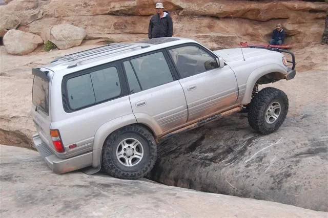

Just one of the cool things about CM is meeting people, putting faces to the Mud names. Unfortunately on Spike we didn't have much time out of the trucks to BS.
I got a couple of good shotts of your rig, PM me your email if you want them.
