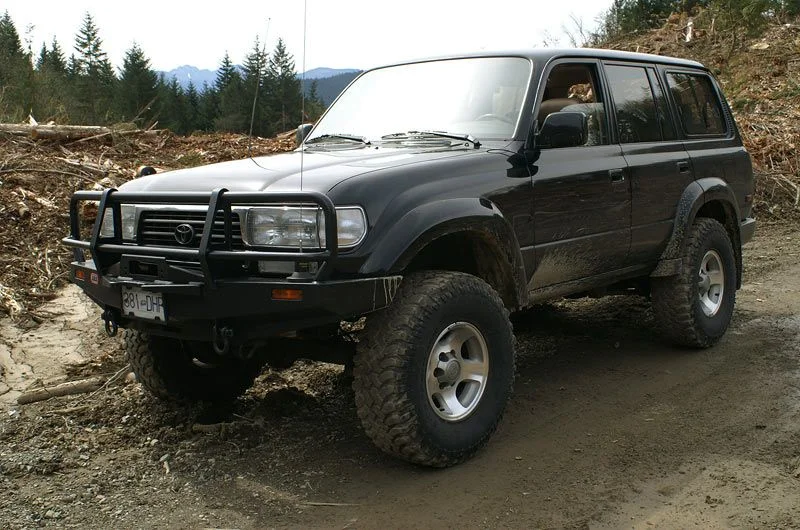

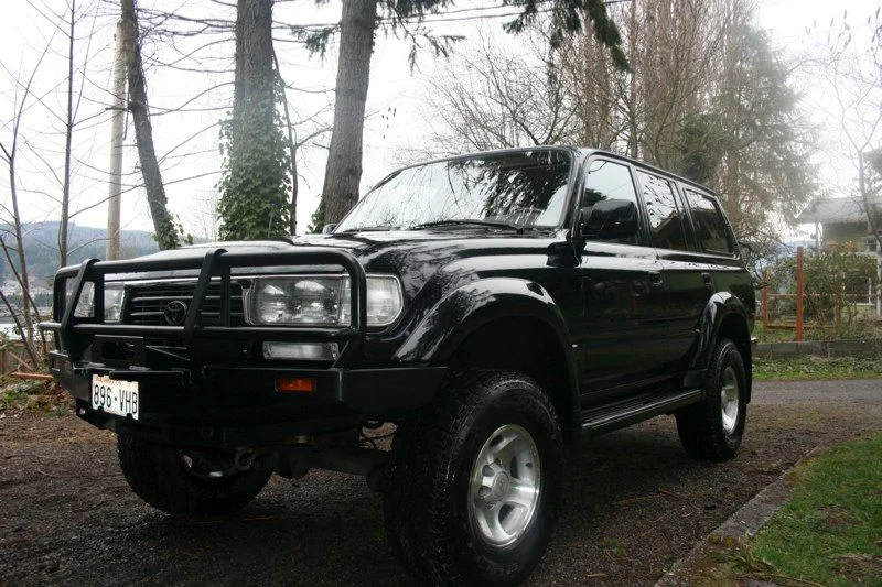

not the best angles either...but
1) 1.5" spacer on AT 285's. stock alloys (pic from montana nate)
2) 1.5" spacer on MT 315's. stock alloys
id run the 1.5's esp for 285's. quarter inch wont make that much of a difference even if you go 315's.

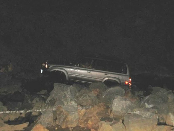

I will say that I think 37 13.50 with 1.50 inch spacer is too much. I rubbed before on my rear panhard mount and when turning rubbed my front control arms without spacers. With the spacers I rub the fender flares and would probably rub the fender if the flares weren't there. But its not enough to make we give up these tires. I love them. I was in about 2.5 feet of water there.

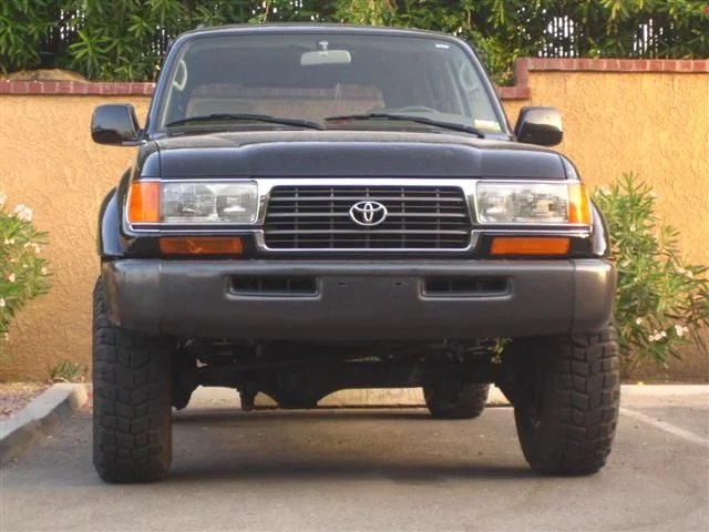

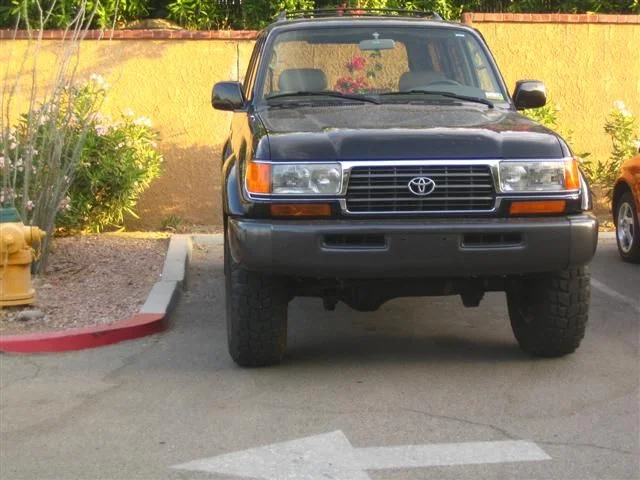

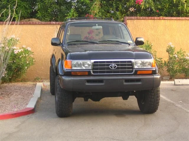

Well, I went with the 1.5" from All Pro Offroad. They were on sale for $138 for all four. I think the 1.5" is the way to go with 285s FWIW. Here are some before and after shots. Thanks for all the replies, Dan.
