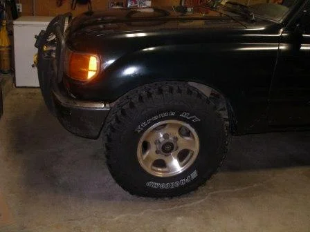

Just thought I'd post up some pics of my 315's with no lift.
no lift, no flares, no rub, no problem!

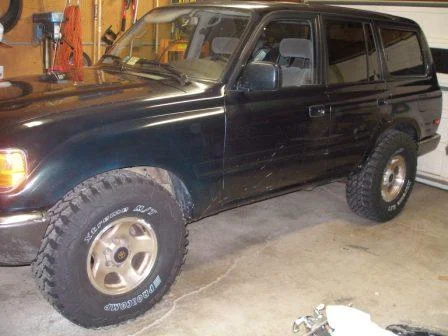

one more

looks good...................but i dont buy it unless you meant just on the way home. course then again i got some 35'' summit racin mud dawgs on the 55 that only measure 33.5 mounted. I did like my procomps on the tacoma though.

Procomptires.com says there actual height is 34.5
I don't think they'd fit mine with no lift.

more pics showing the clearance.
these pics show that there is about 1/4" of clearance between the front tire and the firewall. (note that the front left and right rear are on the bumpstops) The front tires will make contact with one of the bolt heads that holds the inner fender liner on in certain situations. This issue is not much of a problem and could probably be remedied by replacing the bolt with one that has a smooth head that doesn't stick out so far.

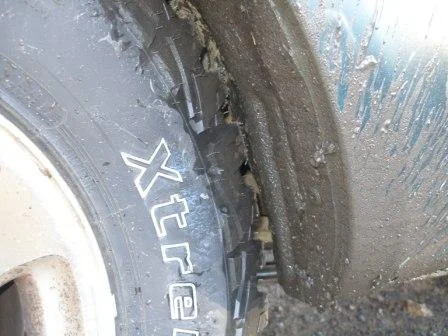

2 more pics of the front tire clearance

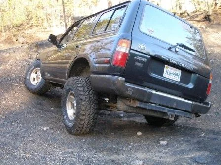

Here are some shots that show the rear tire clearance. The rear tires will gently caress the inside of the rear wheel well under full articulation. Not a problem in my opinion, just enough contact to wipe the mud off the inside of the tire.

2 more of the rear tire clearance

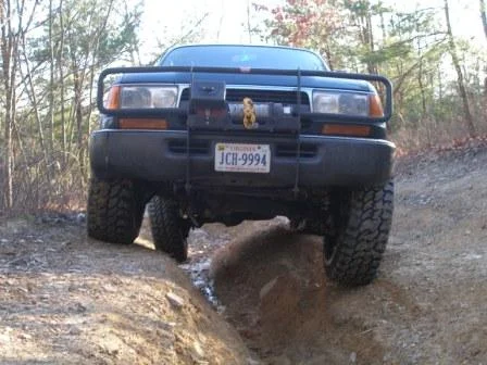

some more pics of the trail action

I doubt you'll stay 35s and stock height for long. Nobody does...
I did the same thing when I swapped from my stock tires to some Nitto 315s.
In slushy mud, there's probably just enough "grease" to make it sound like it barely touches anywhere.
Try it dry....you'll here.....POP POP POP POP and then go look at the bent fender and shaved down tire.
5mph parking lot speedbumps were enough to get the "brrrrrrrrtttttt" noise of the tires contacting the body. Your tires look a bit more aggressive than the Terra Grappler series...so your popping noises should be extra scary sounding for ya.

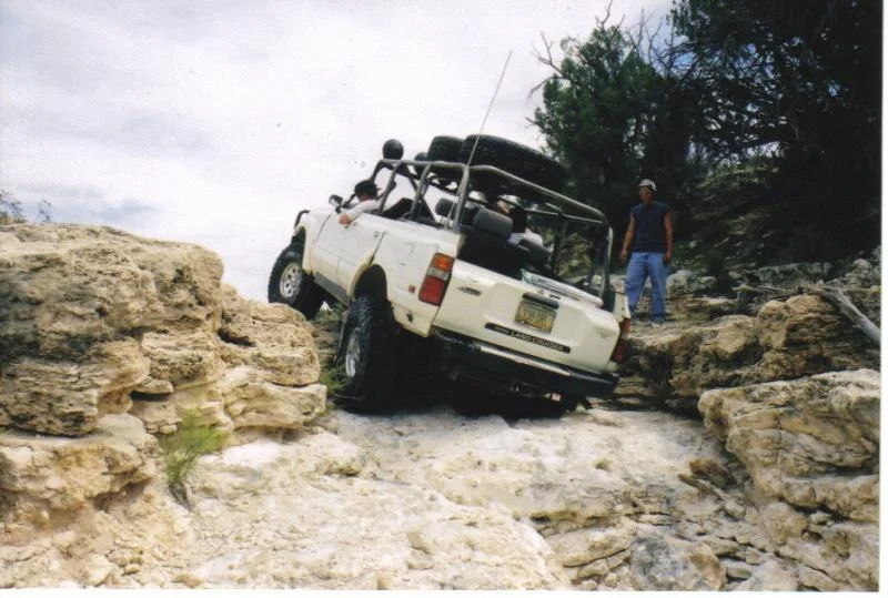

My friend and I both ran 315's at stock level. It rubs the rear fender a little when loaded down, or on big bumps. Nothing major. We've down many trails with these setups, and still have our complete flares attached.
On my old '92 I was running 37's with the 50mm OME springs. They rubbed as bad as the 33's that had the negative offset. It is all about wheel offset. If you keep the tire close it stays inside the fenderwell and has more room for uptravel. If you get wheels or spacers that stick the tire out, the tire runs into the outer fender before reaching the bump stops.
