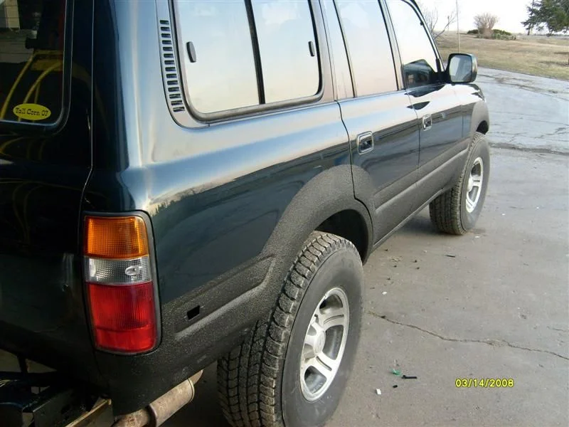

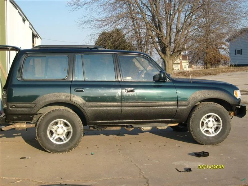

Look what I did with my day off....
Taped all 140 or so holes and put on bedliner today. I used Plasti-Kote from Walmart. It seems like it went on OK - I'll see how well it holds up long term. I still have some touch up to do on the edges as it peeled a little in a few places when I removed the masking. Even the wife approves!!
Tony

What do most of you do with the rear side lights? I can bolt them back on, but they seem to stick out farther than I would like - even with the gaskets under them removed.
Of course, I could remedy that when I build the rear bumper.......

From the side shot, I couldn't tell that was a LX450 - except for the rims and corner lights. Is it on a stock suspension? What size tires are you running? Looks good!

Thanks everyone! My out of shape legs are sore today......
Quote:
Yes, it is stock springs, for now..........I have a OME 850/864 combo sitting in the house waiting for warmer weather. Those are 285/75 Peerless Baja Widetrack AT. Made by Bridgestone - got 5 for under $600.

What kinda tape ?
Did you tape both side of the holes ?
Sorry for the noob questions, never used bedliner before
Andy
moglite is offline   Reply With Quote
Old 03-16-08, 05:21 PM   #21
Amateur Corn Farmer
cheap 40's Avatar
Join Date: Dec 2003
Location: SE Iowa
TLCA# 14426
Posts: 242
Quote:
Originally Posted by moglite View Post
Nice job - so you just taped over the holes for the flares ?
What kinda tape ?
Andy
I used aluminum foil tape like others here have done. Just taped the outside - the liner is thick enough that it hides everything pretty well, except that now it looks like it shrank a little as I can pick out most of the holes. When it warms up again, I'll hit it with another couple of coats. I'm thinking that should just about hide everything for good.
Tony
