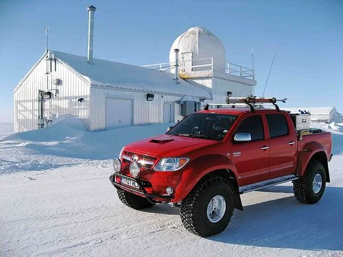

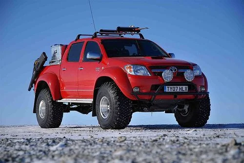

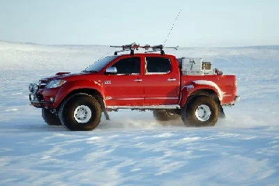

Posts: 152
Speaking of monstrous Yotas. How about this Artic set-up Hilux / Tacoma.

Quote:
uh... random
It's a Hi Lux D4D 3.0 Turbo Intercooled, 1KD-FTV ECU controled common rail y varliable vane turbo.
