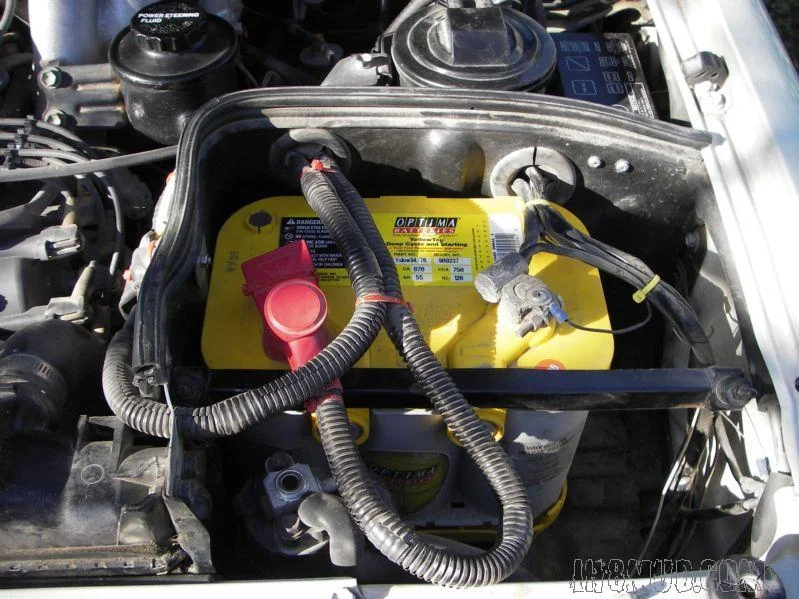

If you don't have any major power-drawing accessories, there are plenty of other batteries at less than half the cost of an Optima that will server your needs more than adequetly. I just purchased an Interstate Mega-Tron Plus Group 24F (p/n: MTP-24F). Better specs than all the Optimas except Group 31 size for $77.16 with tax. According to my local Interstate rep (who sells both brands since Interstate makes Optima) the MegaTron plus is as good or better. I got a good deal since I paid fire department pricing level, but if you're crafty you can probably get the same price.
Interstate Batteries - Every Battery for Every Need

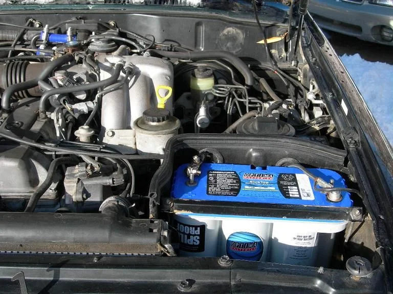

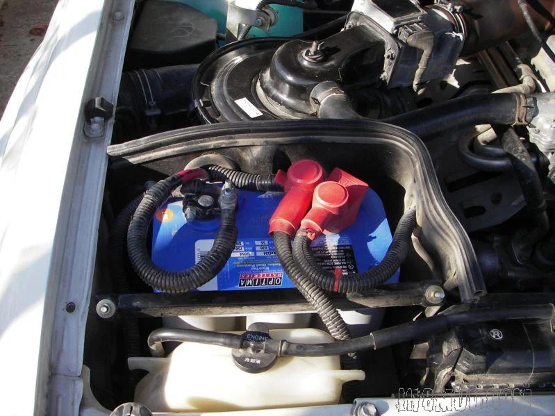

D31A will fit with no mods (also listed as part # SC31DM)

There are two Optima batteries that drops in without any wiring modifications.
The 34R Redtop - "R" for reverse SAE terminals fits perfectly without wiring modifications if you use the Optima spacer under the battery.
The D31M bluetop has offseted terminals that also fits without any wiring modifications. It is a deep cycle battery.

That said, it is a -tight- fit. I'm using factory brackets & J hooks. One of the Zip ties may have had to be removed from the + harness to allow the extra 2" of slack to make the + connection. Hard to remember on that note.
However, there have been some reports that the + cable in some of these trucks is just a touch short to reach on the D31A yellow top. YMMV on this one.
The single D31A in my wife's truck that was formerly in my truck is about 5 years old now. The dual setup in my truck is about 3 years old.
I have no complaints. Details on my big switches & cables & parallel dual matched battery install are in the Dual Battery FAQ.
I bought my D31A batteries before the current conflict in the gulf. The single was $180 at the local auto parts store. Since I wasn't aware of anyone else using these at the time, it was a bit of a gamble to see if it would work. Happy with that, I did some research and found out that Optima also sells them in a two pack of factory profiled & matched batteries. At the time I bought a set for $289 shipped UPS. I bring this up because the prices have changed. A lot. If my batteries fail tomorrow (high 10*F) it would require some serious soul and wallet searching before I would be willing to pay the $300 per unit now +$30 per for matching fee for parallel installations +shipping.
Having $300 in batteries seemed extravagant. A $700 set... just sounds silly.
YMMV

Yellow on DS and and Blue on PS. Both fit fine in stock trays with the plastic battery lifters that came with them .
My rig is a '93 but the cable fitment was not a problem.
I am with reffug, if I had to choose, the yellow top dual purpose would be my choice.
