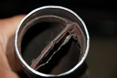

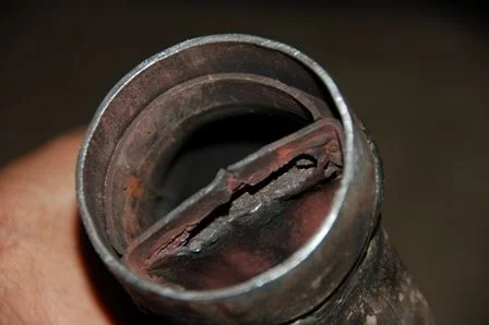

Need to repair/replace "Y" downpipe
After way too long, I finally collected all the pieces I needed to replace my cats which failed due to a leak in the "Y" downpipe joint. I found a good front cat from a wrecked 80, but the down pipe was partially crushed, so I cut the "new" cat off the crushed downpipe with plans to weld it up to my downpipe after I repaired the leak. Unfortunately when I cut my downpipe just below the "Y" I found that it had failed due to corrosion. The flat faces on the two incoming pipes were nearly paper thin. (see first two photos, the third is what it is supposed to look like - unfortunately from the crushed downpipe) There isn't much left to weld, though I am contemplating trying to braze it. So, I am looking for suggestions on repairing this downpipe, if possible.
Failing that, does anyone have a good downpipe available? I don't need another cat and am hoping I might be able to find a good downpipe here in Sacramento. CARB doesn't allow junkyards to sell used cats, so they typically cut them off and sell them for scrap. I am hoping they just torch them off and that I might be able to get the remainder of the downpipe from the truck. I'll check tomorrow but imagine they will not be open until Monday.

The stuff on ebay looks like it was made out of a low grade steel; hard to tell of course from a photo, I sent the seller a question about the steel, etc; will see what they say.
I would think that a custom muffler shop (not one of the chains) could weld up
a Y-pipe for you out of a high grade stainless for not much more than some cheap stuff off of ebay??
You have the cat and the flanges; all they would have to do is get the bends and collector right.
G
G
The photo on the eBay auction is the same as the one on the Bosalna site, thought they are supposedly made by Davidco or somesuch. Please post what you hear back from the vendor.
I'll check with the local muffler shops to see what they quote to make up a new downpipe, though it won't be stainless because I have to weld it to the cat.

The OEM exhaust is all stainless; if you bring your cat and flanges
to a shop that can do it with stainless (if they know how to work with stainless, if not, go somewhere else), they can weld it all up for you, it would actually be better (for you) if they did the entire job.
ie: if you screw it up, you eat it, if they screw it up, they get to
do it again.

You know, after looking at the inside of the Y-pipe at the collector, I am wondering if the infamous 80 exhaust whistle is maybe produced at this point?
Anyone ever run their 80 with just the Y-pipe, and still hear the whistle??

My 80 was whistling, which is how I found out it was cracked. I could also feel exhaust puffing out from the Y when I held my hand up there. I was one week away from a trip to Baja, so I welded up what I could (there were cracks going 3/4 of the way around) and packed muffler paste in the slot between the downpipes. The whistle disappeared. The repair held for a while, but I got a P0420 (insufficient cat function) late in the trip and the whistle came back. About three weeks later my front cat grid collapsed driving home from work. I assume it overheated due to unburned fuel reacting in the bottom. I am guessing the front O2 sensor was reading a lean condition due air being sucked in the crack, so the computer was running the engine in a rich condition. I know my mileage was down.
