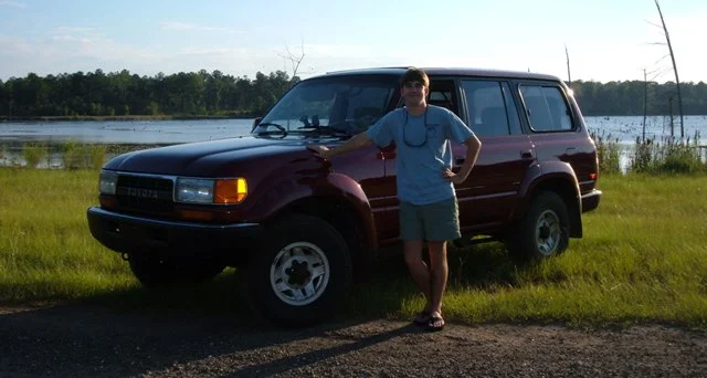

My first Land Cruiser
Hello everyone. I just bought my first Cruiser Sunday in Southern Alabama. I drove about 3 hours to see it, then drove it home. It's a 1992 and has about 270,000 miles on it. It runs GREAT! There is some minor vibration at speed and a clunk when changin' direction, think it's the Dshaft. Other than that, a noisy speedo cable, a busted and shaky mirror, and a couple rusted ends on hard vacuum lines is all I have been able to find wrong. I've put a little under 1000 miles on it. I'm pretty excited about it. I love your forum and hope to contribute as often as i can. Does anyone know any members in South Georgia??

Looks great, welcome to the 3FE club!

Awesome! Nothing wrong with having another 3FE brother around Looks great. Congrats on the purchase.

You're missing some hubcaps.... But hey, congrats!

Nice pic. Congrats.

Slick looking rig, you should come to the Southern Cruiser Crawl at Gray Rock.
