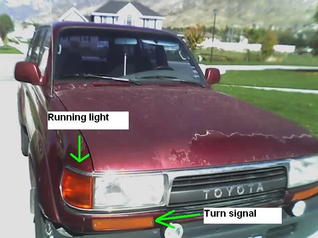

The turn signals and running lights are in two separate locations. (I've actually switched the two, but that is irrelevant)
HTH
_lane

huh, i never paid any attention to that housing on the side, though it was a reflector. Like I said, they have not worked since I bought it...that changes everything...I bet it is the bulbs then...Thank you
