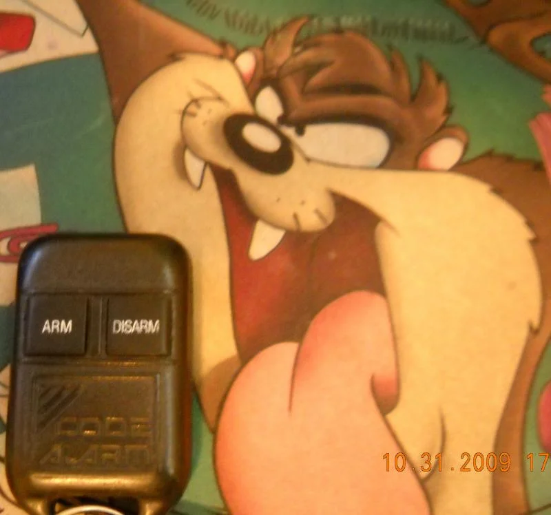

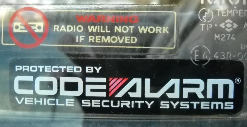

Howdy
My cruiser alarm don't worked when I bought the cruise and in despite that I replaced the battery still to not working. If I am not wrong, is looking like the remote is different the what are posted here. Also, I don't remember to see any black box under driver sit and red light is off. Any info on making this alarm to work ? Better i will invest that 200 $ in smoke bones and let my dog watching the car then pay a dealer to fix my alarm .
Can have this technical problem any connection with my CD player that is not working to ? After window sticker is looking this two system are connected. I don't have the code/s on CD player to do the trouble shooting .

That is not the factory alarm. Code Alarm is aftermarket.

Thanks! Good to know! I will start searching right now for more info .
