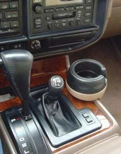

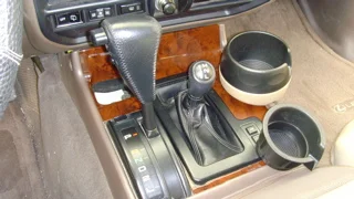

I thought I had posted this awhile ago... guess not. I searched and couldn't find it.
This is a Discovery cupholder that fits perfect. I first noticed it on a friend's Discovery 2 while on a trip and figured it would work on the 80. Comes in really handy.
mount it far enough forward that you can power the seat forward and not too far to hit your drink on the radio. If you don't pull the pass. seat forward, you could mount 2 on that side.

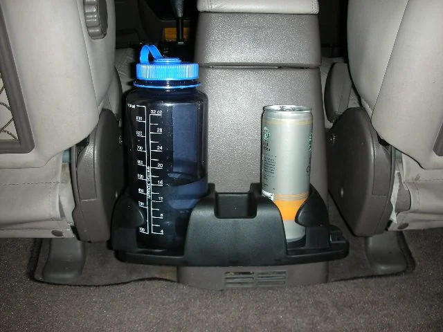

Console Twin
Here's my final product...

The Disco cupholder fits w/ a couple screws (included w/ cupholders). This is literally a 2 min. add-on w/ a phillips head.
There is a 'centering nub' that you can drill a hole for OR just cut off w/ a utility knife. It is nice and stable and really holds any size drink.
Luckily, no LR logos anywhere It looks nice and stock.
Nice rear cupholder Tominator!
