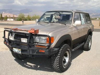

In 97 i did the lift kit so i could put a set of BFG's 33x12.50x15 on her. Then i was told i needed to do a Gear change to make up for the power loss, My Speedo has been FKED UP ever sense.
DONT DO THE BIG TIRE THING, Thats just my advice.

What? MAny people on this board run 35 inch tires with stock gearing and do just fine. I run 33's and ya my speedo is off by about 7mph but that is going to happen if you put larger than stock tires on. You were told you need to do a gear change, but do you really? No, you dont.

WHERE WERE YOU IN 97 ????
Would love to go back to the Factory Gears. Just cant aford it right now.
